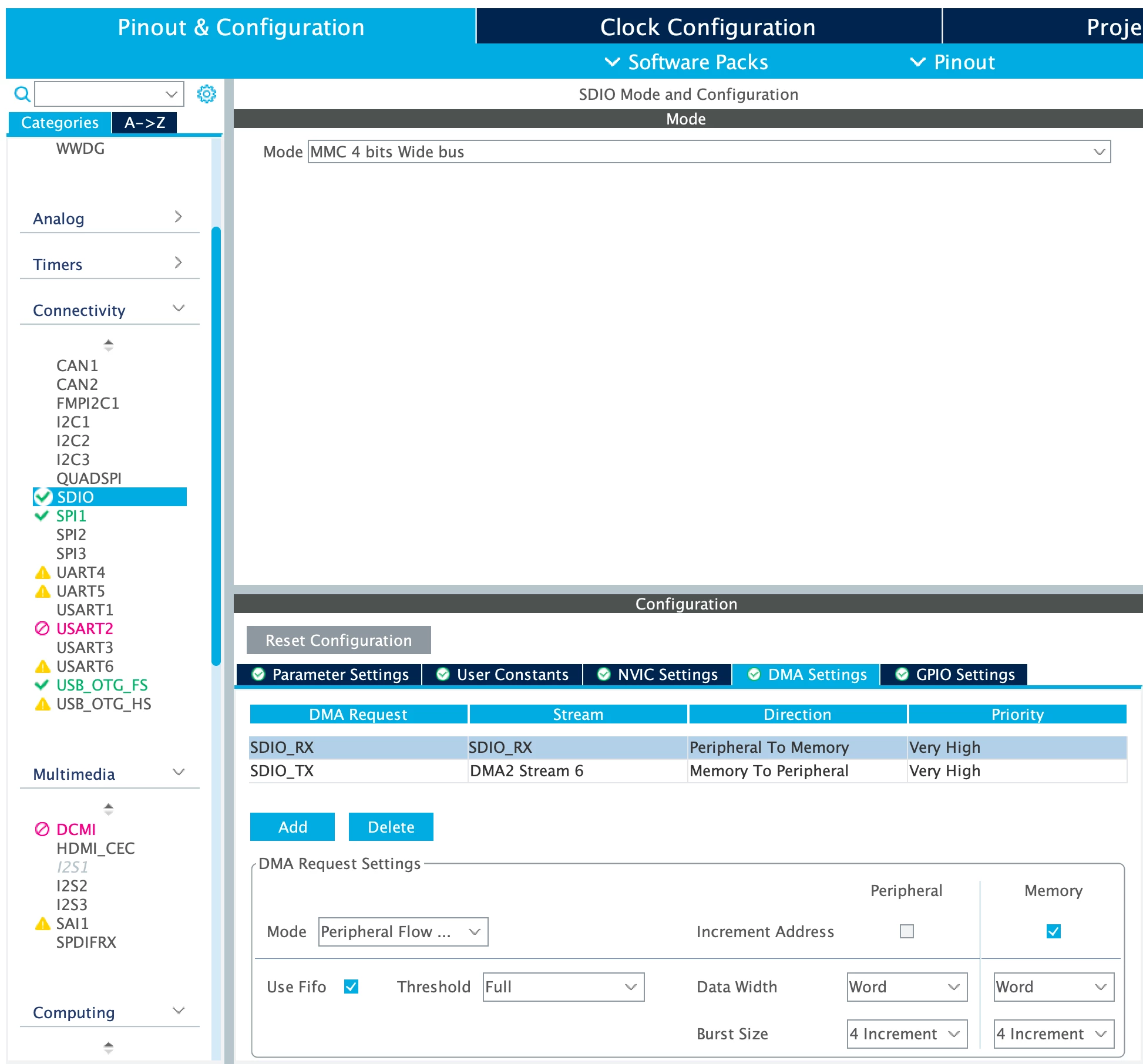

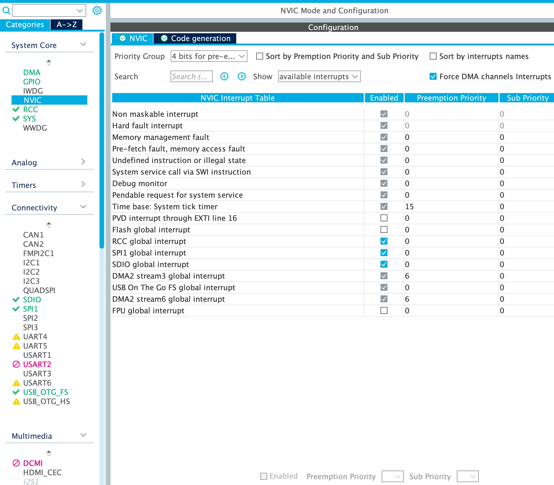

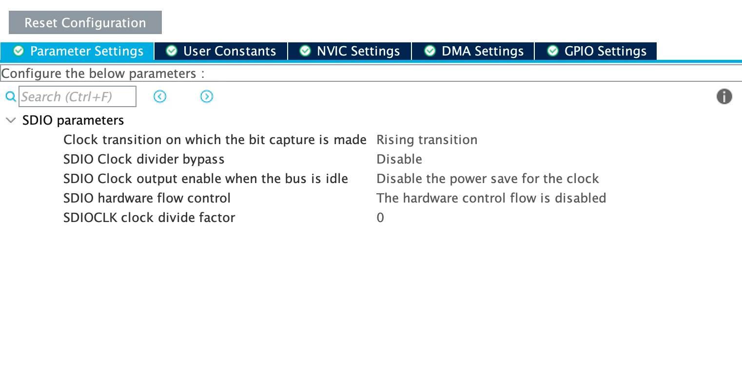

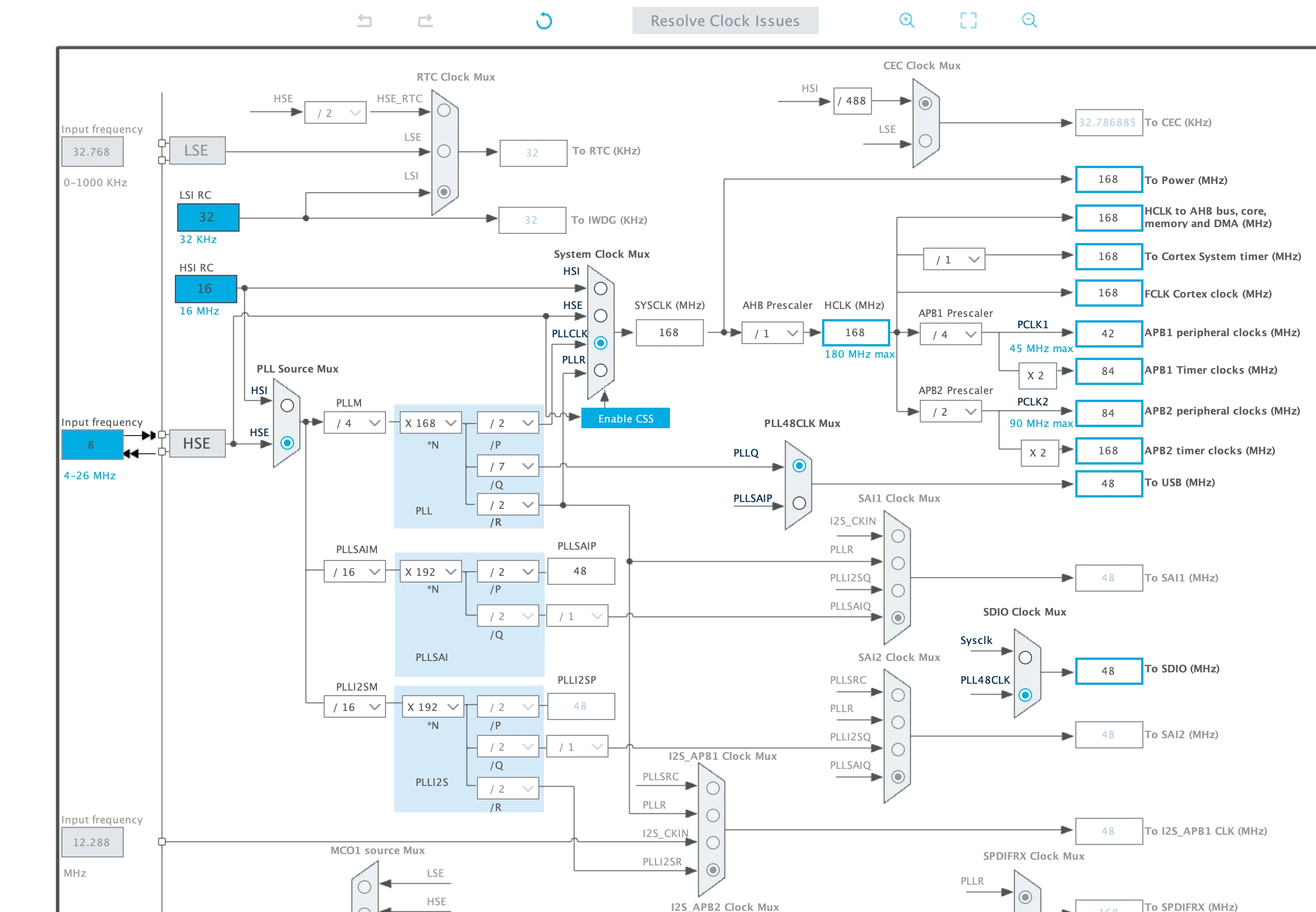

I'm following the example the USB MSC Standalone example provided here:
https://github.com/STMicroelectronics/STM32CubeF4/blob/master/Projects/STM32446E_EVAL/Applications/USB_Device/MSC_Standalone/Src/usbd_storage.c
I am attempting to get the eMMC that is connected to my STM32F466RE to be detected as a Mass Storage device on the PC.
int8_t STORAGE_Read_FS(uint8_t lun, uint8_t *buf, uint32_t blk_addr, uint16_t blk_len)
 /* USER CODE BEGIN 6 */
 uint32_t timeout = 100000;
 HAL_StatusTypeDef status = HAL_MMC_ReadBlocks_DMA(&hmmc, buf, blk_addr, blk_len);
 /* Wait for Rx Transfer completion */
while (readstatus == 0){} // <- STUCK HERE
 readstatus = 0;
 while(HAL_MMC_GetCardState(&hmmc) != HAL_MMC_CARD_TRANSFER)
 if (timeout-- == 0)
 return (USBD_FAIL);
 return (USBD_OK);
 /* USER CODE END 6 */
 * @brief BSP Rx Transfer completed callbacks
 * @PAram None
 * @retval None
void HAL_MMC_RxCpltCallback(MMC_HandleTypeDef *hmmc)
 readstatus = 1;
In the STM32F4 example, the HAL_MMC_RxCpltCallback  function is called to clear the readstatus flag. However, in my code the HAL_MMC_RxCpltCallback is never called and thus gets stuck in the while loop shown in the first code block.
If I remove the while loop altogether, then the code actually does enter in the HAL_MMC_RxCpltCallback as expected and clears the flag. So is the while loop blocking it somehow?
Here's my interrupt, DMA, and clock settings:
Screenshot 2023-09-23 at 1.40.44 PM.pngScreenshot 2023-09-23 at 1.40.59 PM.pngScreenshot 2023-09-23 at 1.41.16 PM.pngScreenshot 2023-09-23 at 1.41.25 PM.png
