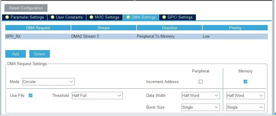

SKris.1616
January 8, 2020
I have attached screen shot of DMA settings.
DMA2 stream3 global interrupt is by default enabled. Do i need to call any function explicitly in my main?
Actually i have defined the call back functions in my code as it is a weak declaration in the HAL.

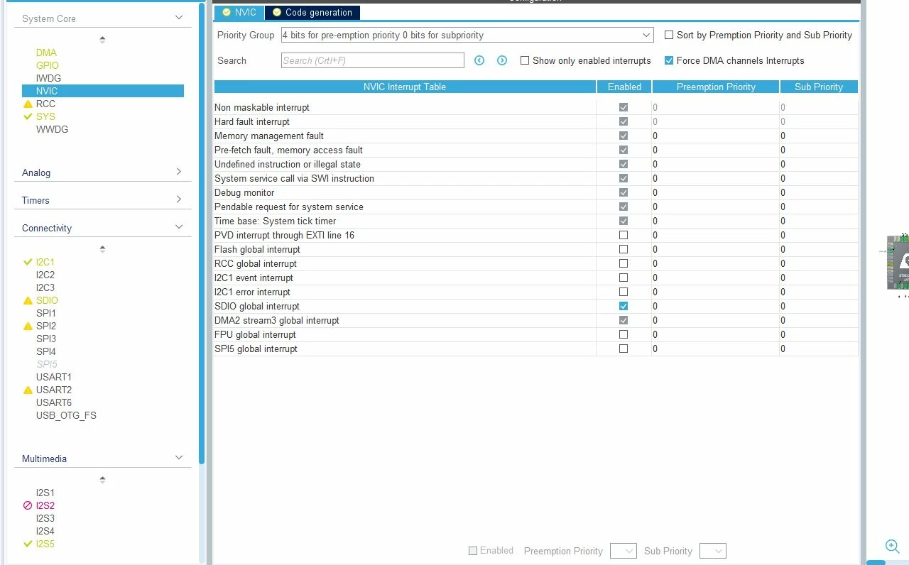

Show "NVIC Settings" tab.
SKris.1616
January 8, 2020
Attached NVIC settings.
Regards,
Suresh.
oleksandr.karbivsky
Senior II
January 8, 2020
Check stm32f4xx_hal_i2s.c file. Put breakpoints on functions I2S_DMARxCplt and I2S_DMAError.
