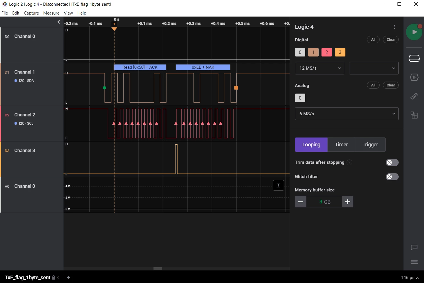

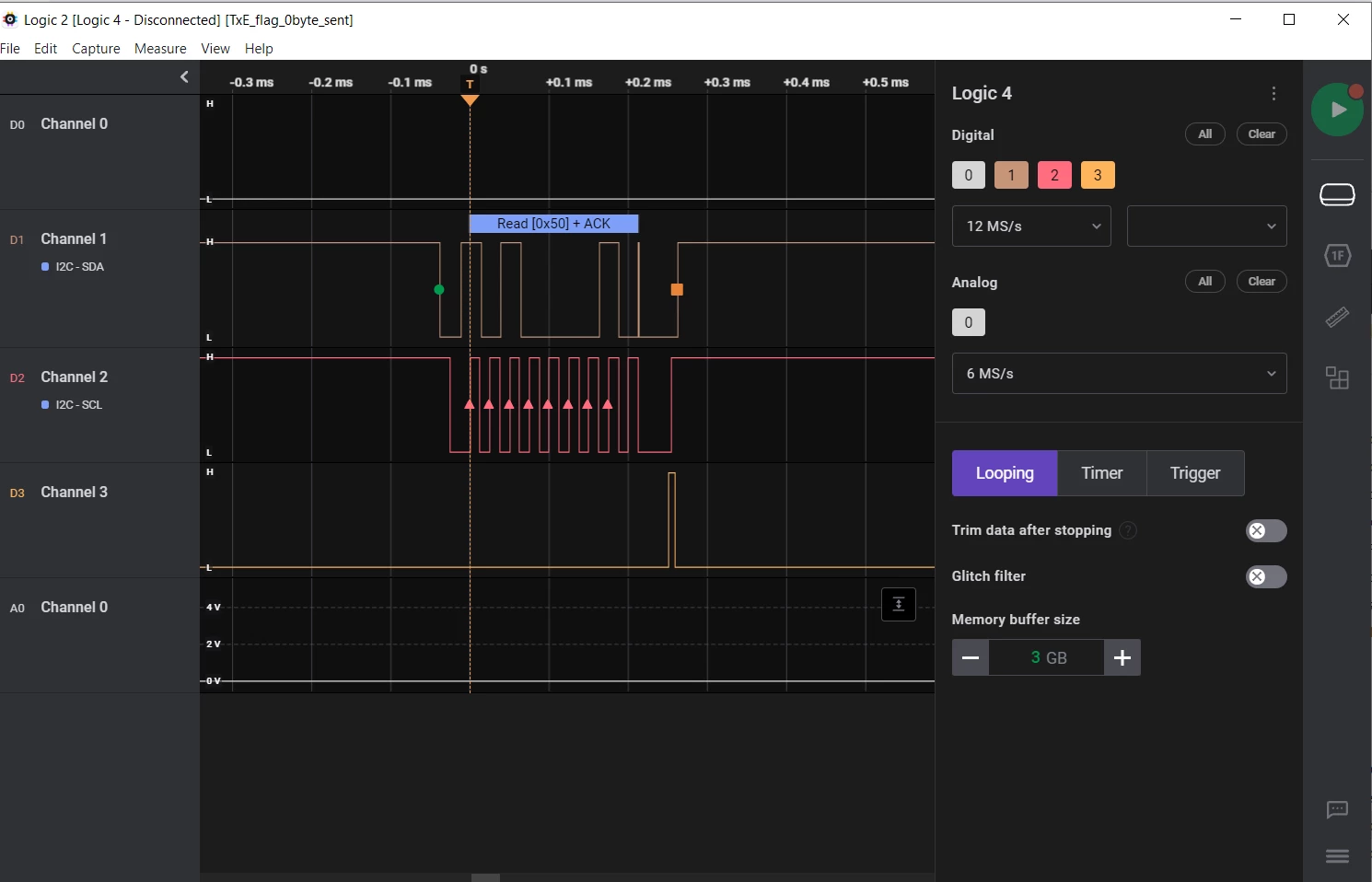

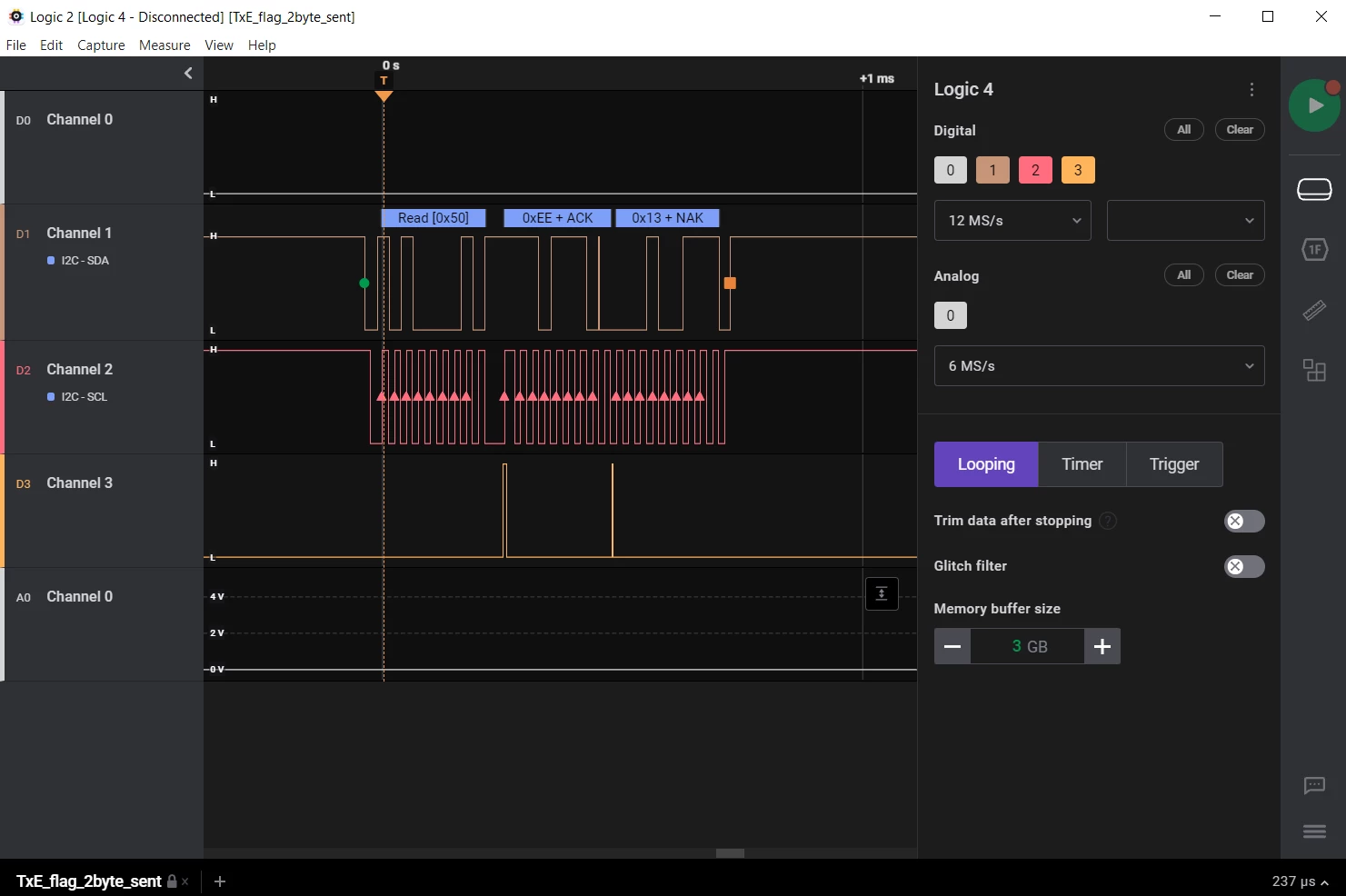

I have made a hack to set a debug pin when TxE bit is set during an interrupt, and clear the debug pin when TxE bit is cleared after DR is written.
I can see that TxE toggles 2 times when host reads 2 bytes, but it only toggles 1 time when host reads 1 byte or 0 byte.
Attaching screenshots from logic analyzer capture. (Channel 3 is the debug pin reflecting TxE bit)0693W00000NqThtQAF.png0693W00000NqThoQAF.png0693W00000NqThjQAF.pngSo I really don´t understand why I receive 2 I2C_SlaveTransmit_TXE callbacks when reading 0 or 1 byte now.
