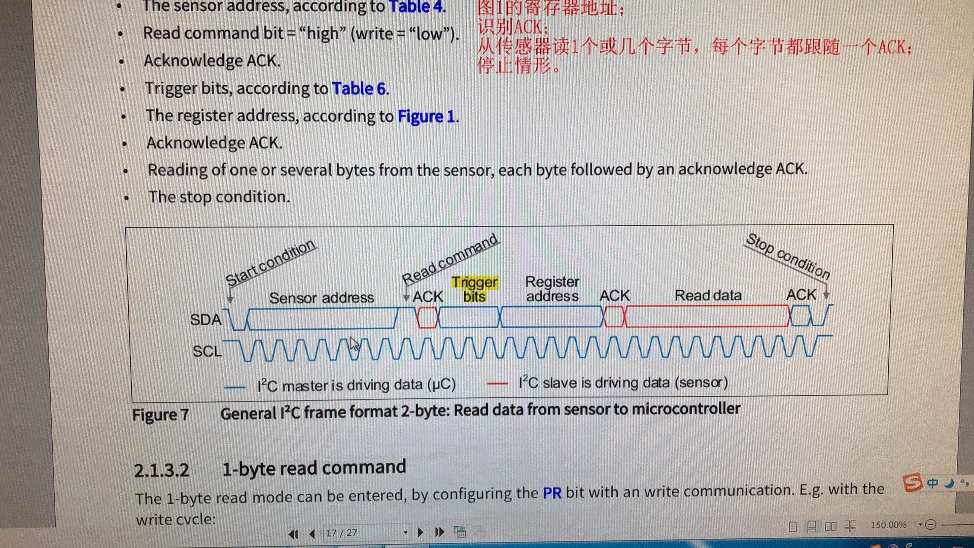

    I'm using HAL_I2c_Mem_Read(), too.
    And may I ask if STM32's I2C can generate wave like the following picture. I have tryed Mem_read() and any other function in i2c.c , but the bit following device addres is "0",which means "write" in I2c.
    May you help me out, thanks.
