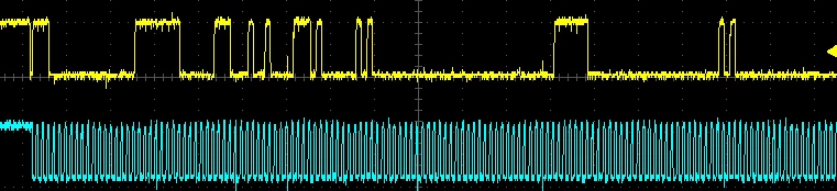

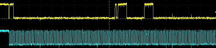

I’m trying to replace a blocking call to HAL_I2C_Master_Transmit() with the interrupt version HAL_I2C_Master_Transmit_IT(). The blocking HAL_I2C_Master_Transmit() call works perfectly. The HAL_I2C_Master_Transmit_IT() call sends completely different data. Specifically:
My buffer contains: 00 00 00 00 00 00 00 BF 00 3F 00 00 00 00 00 00 00
When I call HAL_I2C_Master_Transmit(&hi2c4, I2C_ADDRESS, buffer, 17, 100), I see this:
When I call HAL_I2C_Master_Transmit_IT(&hi2c4, I2C_ADDRESS, buffer, 17), I see unrecognized data:

Probably the buffer you are sending is going out of scope before the transfer completes. Use a global variable.

That was it! Thank you!!!
