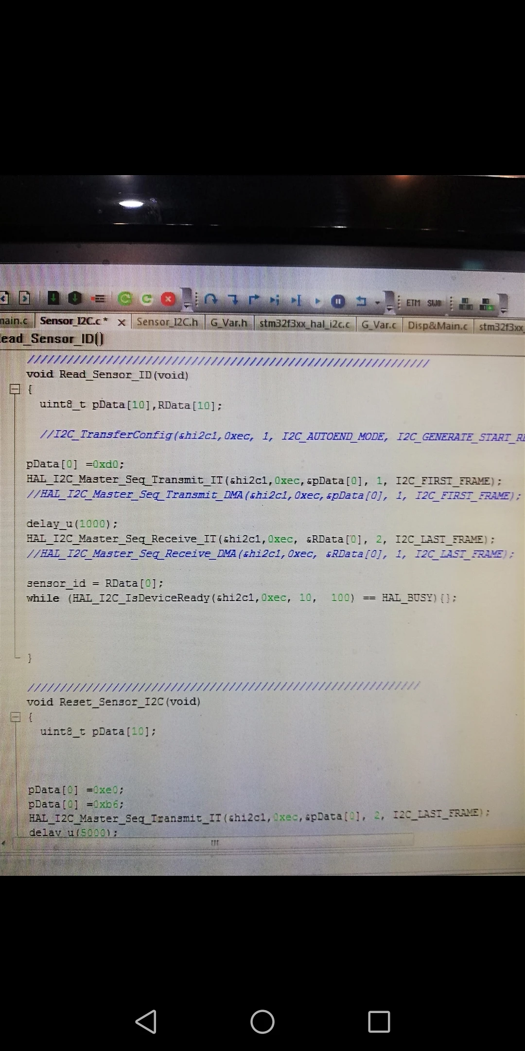

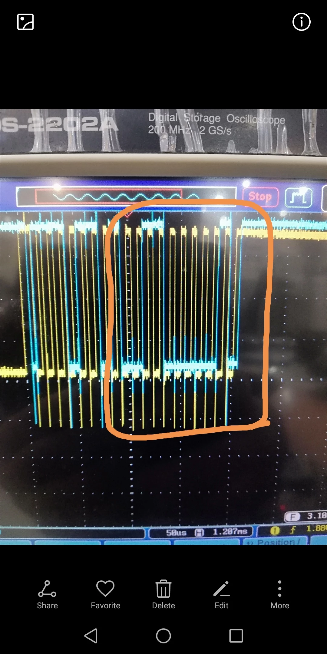

Yes youre right and i had used recieve function. My code image and osciloscope data are attached as you seen in oscope data i am reading 0x60 as id of bme280 sensor which is correct but it is not updated in Rdata buffer
ABah.1
ABah.1Author
July 25, 2020
Oscope data

For register reading one must use HAL_I2C_Mem_Read...(), not those separate functions, which put stop bit in the middle of transfer.

I should use the following relation to read data
Start
Slave addr
Internal reg addr
Repeated start
Slave addr
Reading n byte
Stop
Beacau oof need to repeat start i have used sequential functions which are ok.
Hal_i2c_mem_read doesnt support above hirerchy

You're wrong - it does it all in a single call because that's the whole purpose of that function!
