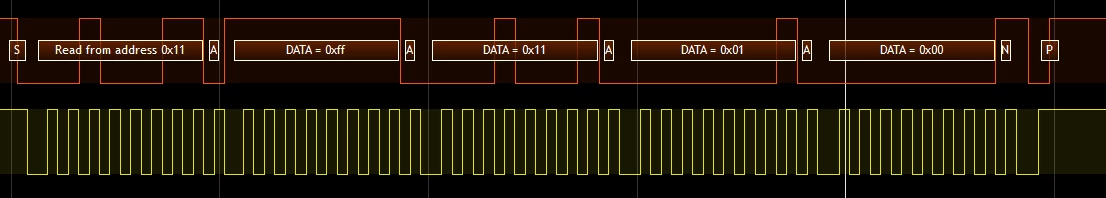

HAL I2C always sends 0xFF as first byte when responding to master using HAL_I2C_Slave_Transmit
  • August 11, 2020
  • 6 replies
  • 3875 views
I have an STM32G4 using the HAL function HAL_I2C_Slave_Transmit to respond with some data when requested by a master on the I2C bus. In the image below you can see the device sends 0xFF followed by the actual data it was meant to send (the data I am expecting is 0x11 0x01 0x00).

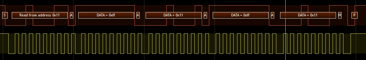

If I instead use HAL_I2C_Slave_Transmit_IT then I get a worse result, as shown below:
I have tried this with the minimal test program below so I don't believe it's anything to do with my full program having a delay:

For my current testing the master is an Arduino Nano using the Arduino function:
Wire.requestFrom(ADDR, 4);
I am requesting 4 bytes because the initial byte is garbage (0xFF). The STM32 is clocked at 128MHz so I don't believe it is possible that it is running too slowly to respond to the first byte - I think it must be a problem with the HAL! Any advice?
