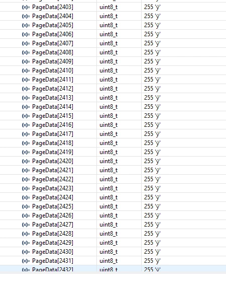

i use PageData as variable in RAM with size 4096 (1 page)
For each time that i want to write data to a flash location (this is occasionally) i do this :
a) PageData is updated with the information read from the last page and then the page is wiped in function eeprom_storepage_and_erase()
b) new data is updated in PageData at the correct index.
c) I write the full PageData variable into the last page with flash_page_write(FLASH_EEPROM_BASEADDR,(uint64_t*)PageData);

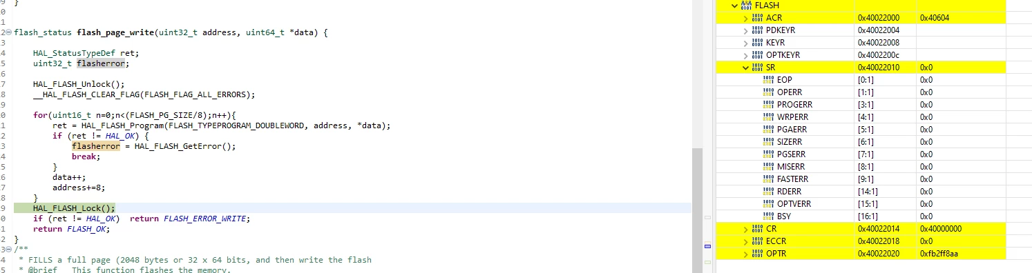

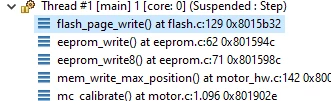

This seems to fail somewhere randomly in the for loop of flash_page_write() ) .
When it fails the HAL function fails and HAL_FLASH_GetError() returns 0x40 which is size error ?
How can this happen when data and address is still well within the boundary?

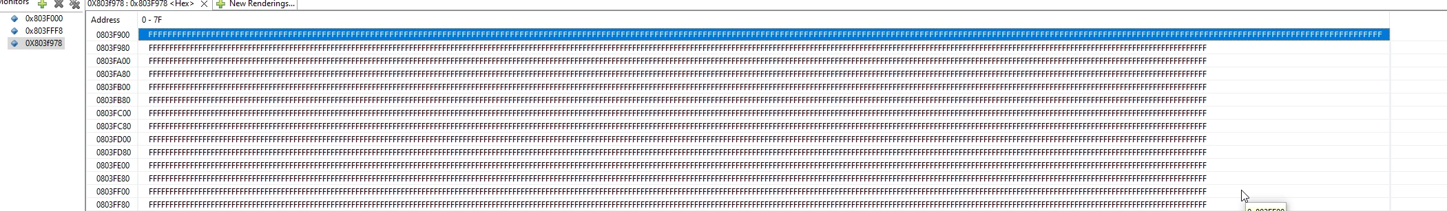

During debugging i found these locations when entering flash_page_write
PageData (0x20003660)
address (0x803f000)
