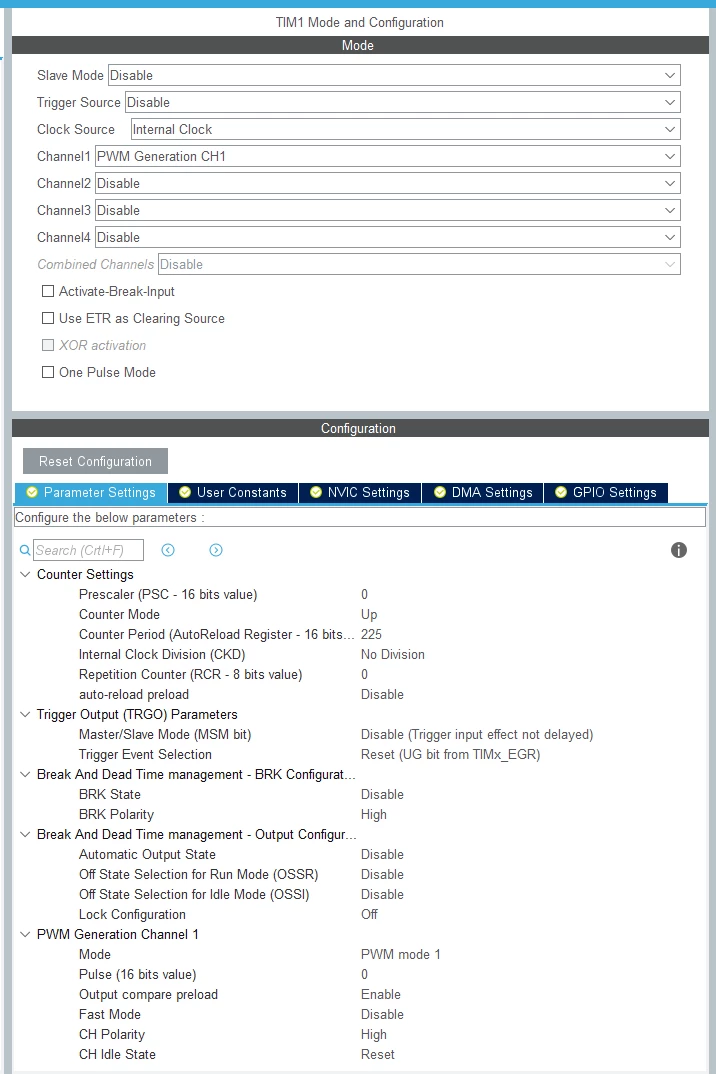

To realise this concept (which is valid or isn't it?) I used the STM32CubeIDE with STM32CubeMX.
In CubeMX I configured TIM1 to be clocked at around 800kHz by setting no prescaler, a Counter Period of 225, setting Channel1 to PWM_Generation_CH1 with PWM_Mode_1.

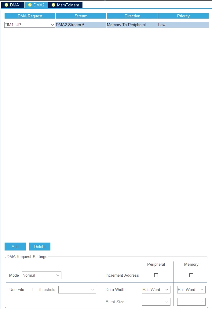

For DMA I added a request triggered by TIM1_UP from Memory to Peripheral with a data width of half_word.
The CubeMX settings are also visible in the pictures of it:

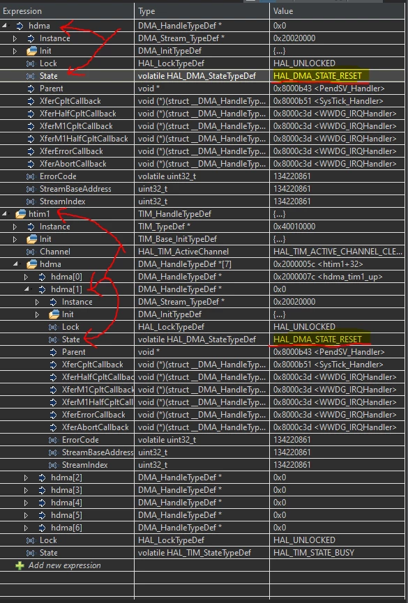

In my case, HAL_DMA_Start_IT returns HAL_BUSY. This is due to its hdma->State not being HAL_DMA_STATE_READY.
I checked and instead of that, hdma->State is HAL_DMA_STATE_RESET.

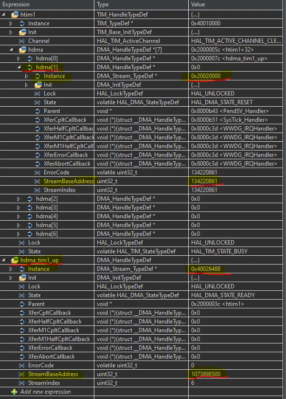

So, htim1.hdma[1].State is HAL_DMA_STATE_RESET, when calling HAL_TIM_PWM_Start_DMA; In HAL_TIM_PWM_Start_DMA htim1.hdma[1] is passed to HAL_DMA_Start_IT as the argument hdma.
The described tracing above is also visible through the source of these functions and the attached image of the debugged TypeDef values:

HAL_DMA_STATE_RESET indicates the DMA has not been initialized.
There should be a call to HAL_DMA_Init within HAL_TIM_Base_MspInit which will initialize the DMA. CubeMX should generate this code for you within "stm32f4xx_hal_msp.c".
WBach
WBachAuthor
Jul 29, 2020 9:24 PM UTC
Thank You for your quick reply.
I checked and there is indeed a call to HAL_DMA_Init within HAL_TIM_Base_MspInit, which also gets called on startup.
However there is one thing that seems wrong/weird to me.
When looking at the source of HAL_TIM_Base_MspInit, more specifically the call to HAL_DMA_Init, the argument being passed to HAL_DMA_Init startles me:
if (HAL_DMA_Init(&hdma_tim1_up) != HAL_OK)
 Error_Handler();
The argument hdma_tim1_up is not the same as htim1.hdma[1], which causes the problem.
These are the TypeDef values of hdma_tim1_up and htim1.hdma[1]:
From looking at the Instance value and the StreamBaseAdress I would assume they are not the same or am I wrong?
From looking at the debugged TypeDef values, hdma_tim1_up.State seems so be HAL_DMA_STATE_READY, while htim1.hdma[1].State is HAL_DMA_STATE_RESET.
Do You understand this?

I think the underlying issue is you have DMA set up for the update event, not for the CH1. When you add a DMA request, select TIMx_CH1 instead of TIMx_UP.
WBach
WBachAuthor
Jul 29, 2020 9:53 PM UTC
Thank you for the reply.
This looks quite promising, I am currently testing it and it works so far.
However, it confuses me, since the DMA Request/Transfer should occur, when TIM1 overflows (hence TIM1_UP), and not when CH1 matches.
I will test which is the case but the name of the request "CH1" hints to be when CH1 matches, which would be wrong for my principle.
I will test, which it is or alternatively, can you tell me/do you know?

Ok, it seems to be triggered when CH1 matches... But I need it to trigger when TIM1 overflows. How would that be achieved?
Jul 29, 2020 10:16 PM UTC
> However, i still would ask, what is the sense behind that naming scheme then?
I believe the "CH1" name indicates the DMA is going to service CH1 in some manner, either transferring data from or (in this case) to the CCR1 register. Whereas update just means it's triggered by the update, but not necessarily doing anything in particular.
You can have multiple DMA streams each serving a different channel on the same timer, so it would be confusing if they were not separated by name somehow.

So I guess I am not supposed to use TIM1_UP in CubeMX with HAL_TIM_Encoder_Start_DMA.
So I searched for TIM_DMA_ID_UPDATE, which kind of equals selecting TIM1_UP, in stm32f4xx_hal_tim.c and found it as an valid option in the functions HAL_TIM_DMABurst_WriteStart/Stop and HAL_TIM_Base_Start_DMA.
As I already wrote, HAL_TIM_DMABurst_WriteStart/Stop is pointless for my application but I will check, what exactly HAL_TIM_Base_Start_DMA does...
Any thoughts on these results?
EDIT2: Yeah, the preload feature would seem to work here, however I would really like to figure this error out, since the preload solution is kind of a workaround and not a genuine solution.
WBach
WBachAuthor
Jul 30, 2020 5:05 AM UTC
Ok I took a look at HAL_TIM_Base_Start_DMA... And it does not seem to be the solution. In its Source there's:
if (HAL_DMA_Start_IT(htim->hdma[TIM_DMA_ID_UPDATE], (uint32_t)pData, (uint32_t)&htim->Instance->ARR, Length) != HAL_OK)
 return HAL_ERROR;
So it seems to be triggered by what I want, which then also calls the hdma, which is initialized but the third argument shows it modifies the Auto Reload Register, which is not what I am aiming for. I am seriously considering just modifying this source to also enable different addresses for this argument, in case it doesn't need a call to HAL_TIM_Base_Stop_DMA for each transfer...
Any thoughts on that?

May 12, 2021 3:36 PM UTC
Used this thread to reorganize my thoughts about it and git it working. Heres my quick and general cookbook on it.
  • init timer and DMA(Remember to select the correct DMA type in CubeMX)
  • Call HAL_DMA_Start() with your parameters if you arent using capture/compare DMA requests.
  • Start your timer using your regular start function or if youre using CC DMA requests you can use the _DMA version of your timer start command.
  • OBS: if you didnt know the DMA handles are placed as a subset of htim. There are 10 of the corrosponding to each DMA channel.
  • OBS: if you dont know what channel the dma is using check the bottom of the HAL_TIM_Base_MspInit() function. One of the linked channels is the one you want to be using (in my case TIM_DMA_ID_UPDATE aka channel 0)
  • OBS: HAL_DMA_Start() expects datalength to be the number of elements in your buffer NOT the number of bytes.
  • OBS: If (like me) Youre writing to registers with reservered registers inbetween remember to account for them when setting TIM_DCR_DBL and TIM_DCR_DBA. As an example if you wanna write to ARR, CCR1 and CCR2 youd set TIM_DCR_DBL as (4 - 1) shifted into position and youd set TIM_DCR_DBA to (0x2C/0x04) where 0x2C is the adress for ARR (The first in the sequence) and 0x04 is the address spacing between registers.
    • Furthermore remember to size your buffer properly and remember theres a reserverd register in the middle. In the above case the register values would be places in the buffer as follows
uint32_t buffer[4] = {ARR_Val, 0, CCR1_Val, CCR2_Val};
These where the major hurdles i had. Ill add to it if i remember something else important later. Feel free to ask for details if you need it ill try my best to lend a hand like Bach did to me.
Best regards, Malte
