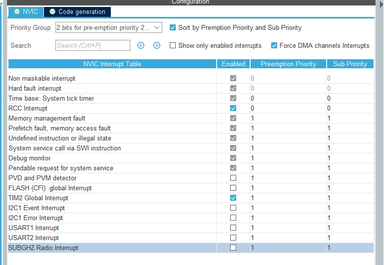

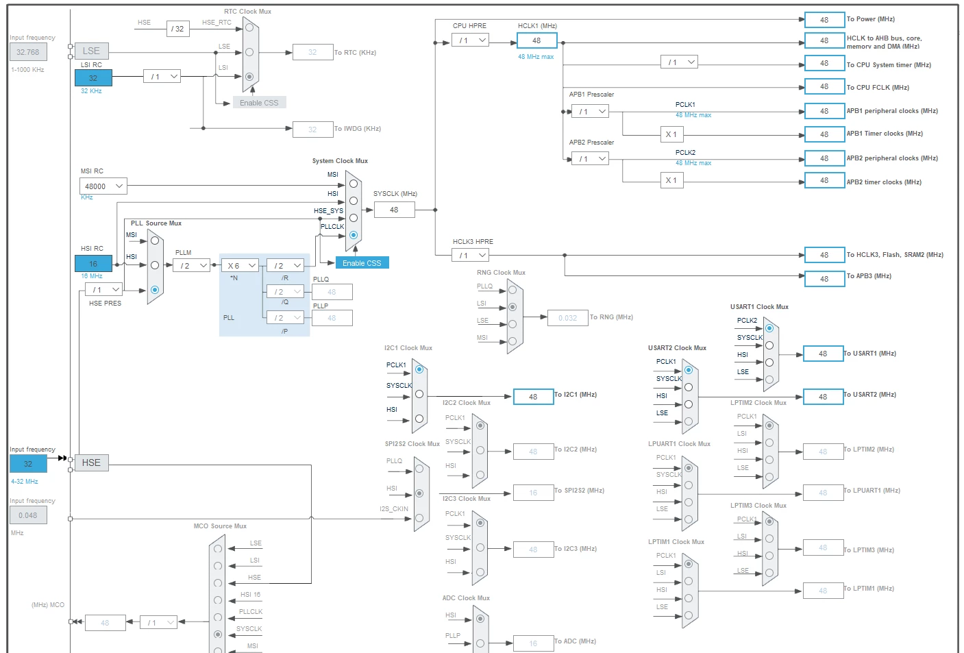

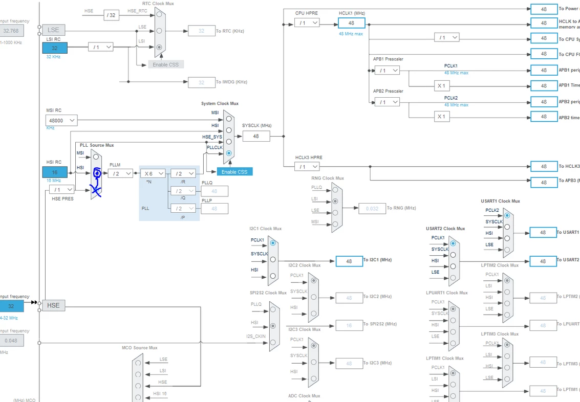

The LED turns on and the Code gets stuck in the Delay. I do think the interrupts are set right. 0693W000008ys3zQAA.pngAn this is my Clock Configuration:

Ensure Systick is enabled in System Core / SYS / Timebase source
I had a bug once where Cube IDE was missing the systick ISR code.

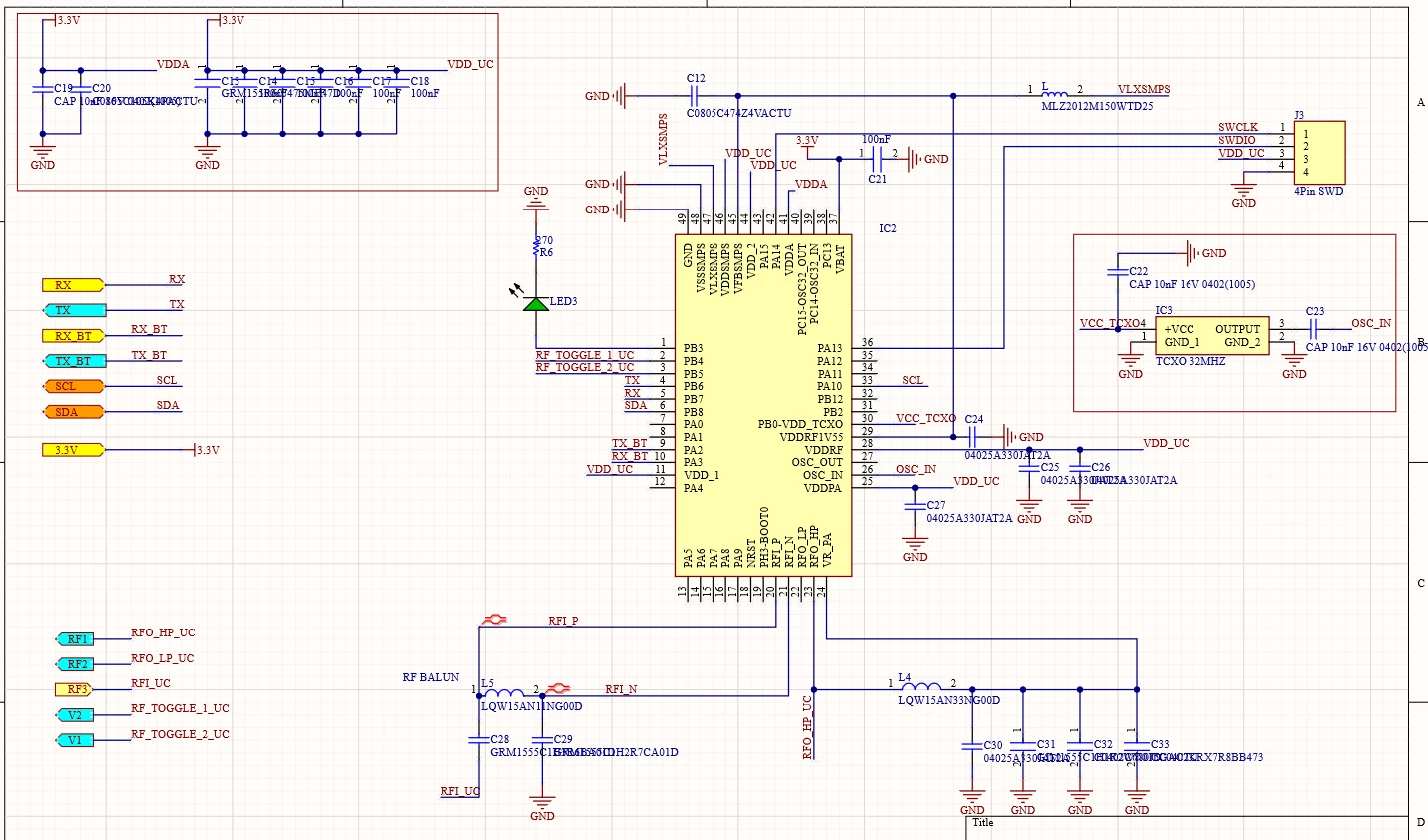

GHube.1
GHube.1Author
April 9, 2021
The while loop did work perfectly.
Also with the 16Mhz HSI/MSI 32Mhz no improvement. While stuck in the Delay i did a reverse step, and i think its stuck in:
 while ((HAL_GetTick() - tickstart) < wait) { } and then the HAL_GetTick(void) function >
 return uwTick;
 BOOT0 pin was unfortunately left floating.
i read somethin about the Low Power modes and that the HSI is turned off in certain sleep modes. But i don't think i chose/activated one of those.
0693W000008z8OoQAI.pngThats the main shematic. Pin 30 is +3V3 for the clock, pin 26 the input.
