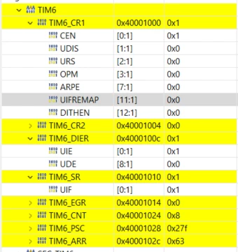

I'm working on the µc STM32H5, I have an application that runs correctly, and when I configure the threadX in the project for which I've configured the TIM6 as the basic timer and I've released the SysTic for the threadX using CubeMx. I've had a problem with the HAL_Delay API, which doesn't work outside my configured tasks because the TIM6 handler isn't triggered and consequently the uwtic doesn't increment any more.
In NVIC I've configured a priority of 15 for the TIM6.
After debugging I found that the TIM configuration is correct but the Handler is not triggered.

Hello @Sarra.S,
Thanks for the answer,
I mentioned in my previous comment that the TIM6 configuration is correct.
If I don't use the HAL_Delay outside my threads, the handler of TIM6 triggers and works correctly. But the problem is that when I add the HAL_Delay outside ThreadX tasks, the code gets stuck in this construction and prevents the TIM6 handler trigger.
Below is TIM6's config:

I tried to configure the TIM6 with a high priority and had the same problem.
