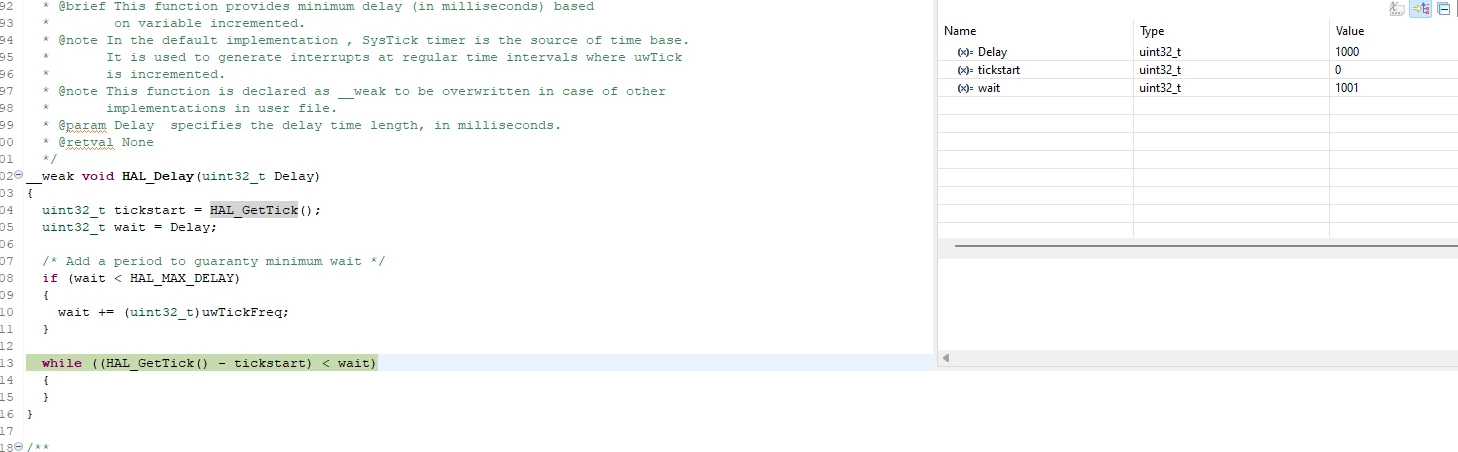

so this is the inside debug of delay:
_legacyfs_online_stmicro_images_0693W00000biAu0QAE.pngit gets stuck at this while

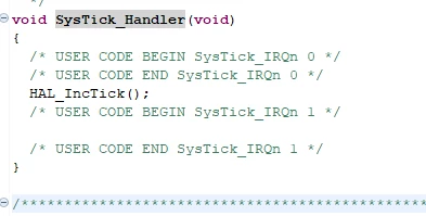

Make sure SysTick_Handler() is calling HAL_IncTick(), that it's not weak, and that it is binding into the image.
Double check SCB->VTOR pointer to your Vector Table address, and that the interrupts aren't disabled.

ok so this is systick:
_legacyfs_online_stmicro_images_0693W00000biAvNQAU.pngand this is hal_gettick
AScha.3
Apr 16, 2023 1:52 PM UTC
seems: sysclk not running ...because tickstart should not stay at 0.
should be so: (> 0)

and in ***_it.c file you should have :
PPopo.1
PPopo.1Author
Senior
Apr 16, 2023 5:30 PM UTC
I have that

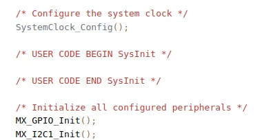

AScha.3
Apr 16, 2023 8:00 PM UTC
why is sys-clk-config light grey ?
PPopo.1
PPopo.1Author
Senior
Apr 16, 2023 8:07 PM UTC
no idea actually, seems normal to me in the editor. I changed theme to black now to see the difference but they all look the same either way

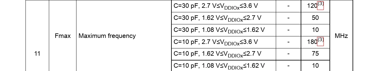

AScha.3
Apr 17, 2023 11:07 AM UTC
>but Im not sure how much can gpio handle
read in DS , p. 135 . depends on core voltage/speed setting , for high 11 ->
_legacyfs_online_stmicro_images_0693W00000biEBxQAM.png>I have no idea what could be the issue
me too.
try new project ? and leave everything, as it is, no modified settings.
