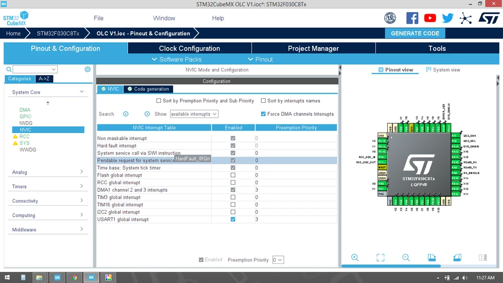

parth kothiya
January 5, 2022
Systick interrupt having higher priority as shown in image
uwTick is increment also​ systick interrupt also call but still goes in infinite loop
