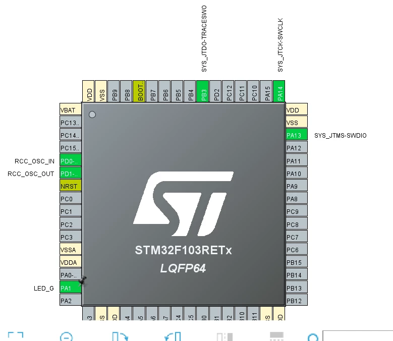

I'm trying to upload code to an STM32F103RET6 MCU and have a simple setup by now (see image below). I have attached a LED to pin PA1 as a GPIO OUTPUT and an external oscillator at 16 MHz. The other three pins are connected to the JTAG connector that goes to the STLINK v2. 0693W00000ANu5wQAD.pngWhen i generate the code to perform a simple blink I'm having trouble with the HAL_Delay function. The code is shown below.

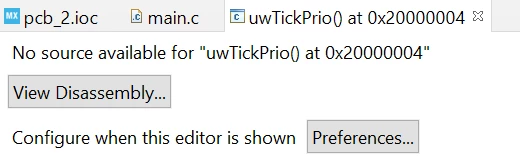

The connection with the MCU is fine and the code starts running, so the first line that is to turn on the LED is executed correctly and the LED turns on. The problem is when the
HAL_Delay(500)
 is executed, it stops the code and the following message pops up: No source available for "uwTickPrio() at 0x20000004" See image:

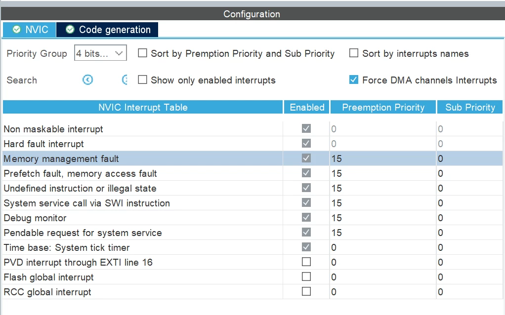

0693W00000ANu6BQAT.pngI have tried setting the NVIC preemption priority as i have seen that was the solution to many people having a similar problem and the setup is like the following:

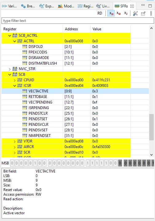

Examine the SCB->ICSR register VECTACTIVE bits to find out what interrupt the CPU is in. Verify that interrupt handler exists in your code. Probably the issue is with handling the SysTick event, as HAL_Delay is unlikely to cause issues.
Not real sure though, maybe try creating a new project.

I don't really understand what is happening in this register. I add a screen capture in case it was useful. 0693W00000AOXO9QAP.png

VECTACTIVE = 3. To find which interrupt it's handling, subtract 16 and look it up in IRQn_Type. In this case, it's executing the HardFault_IRQn interrupt, which means something in your program went wrong. Other SCB registers will shed more light into why a hard fault occurred.
Note that VECTPENDING = 0xF, which is the SysTick_IRQn, but it never gets there because it's in the hard fault handler.

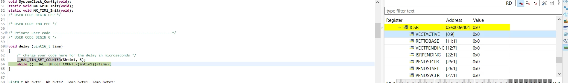

0693W00000DnRYUQA3.pngHad same issue happening. I checked the VECTACTIVE and it's 0 in debug mode. Program cannot get out of the loop given in screenshot. I tried changing the stm board to check it is hard fault related but still same issue happening.
Also i am using CubeIDE and HAL libraries but we tried programming and debugging in standard library and it worked well. So probably problem is about HAL libraries, but i couldn't figure it out.

The code show needs a TIM to be clocking, and the number ranges need to be appropriate.
Is it a down counter, or up counter?
On a 16-bit TIM?
Could the range of the TIM always be below the threshold?
If the TIM clock isn't enabled the count will always be zero, and it will never leave the loop.
There are far better ways to do delay loops using free running timers.

"No source available for "uwTickPrio() at 0x20000004" happens due wrong boot mode. chip try to run bootloader but debugger try to debug real app.
