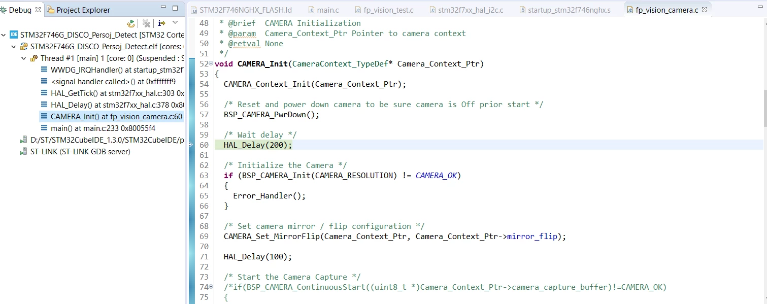

hello,
i'm debugging this code suddenly i got a hard fault as shown in the figure:
how can I solve this

Looks like it’s in the watchdog IRQ handler. Unlikely that HAL_Delay caused the issue.

The watchdog raises the hard fault because it catched an infinite loop in the HAL_Delay my friend, so the HAL_delay causes the hard fault

Is HAL Tick advancing? Or the delay you're attempting spaning the watchdog?
Bringing up the camera before the SysTick/TIM driving the tick has been initialized?
