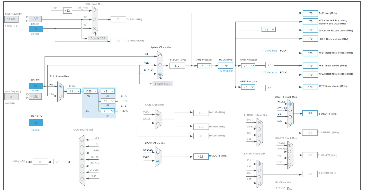

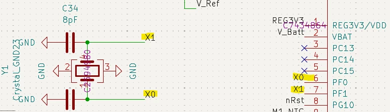

Hello, I have a custom board wich is based on the evspin32g4-dual Board. I generated the code with motorcontrol work bench and could upload it with a j-link. I added an uart output in the startup and noticed that it kept printing it, so the board was constantly resetting. When I stepped through the code the problem was in HAL_Delay, as the HAL_GetTick() function always returned the same value, thus not leaving the function. Could there be an error with the external Crystal? I am using a ECS-240-8-37-CKM-TR with 8pF caps.

Hello @QuirinS,
The HAL_GetTick() function relies on the SysTick timer, which in turn depends on a stable clock source, so yes, probably it's an issue with the crystal.
You can refer to AN2867 for oscillator design guidelines.

Jun 19, 2025 11:31 AM UTC
I would try to verify this by building a version using the internal oscillator (HSI).
Check the PLL settings to get the same system clock rate as with the HSE.
QuirinSAuthor
Jun 19, 2025 12:24 PM UTC
Thanks for your reply, I just checked the project and HSI is already in use.
