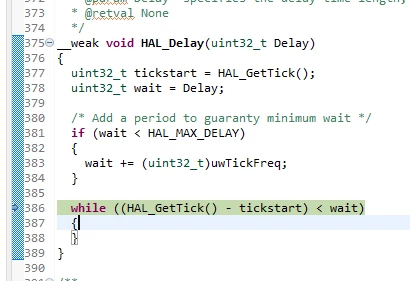

I tried the Hal_Delay function but it's not work Do you have any idea for this error ?
0693W00000aITvBQAW.pngAnd my code still waits at this loop :
0693W00000aITvqQAG.pngThank you for your helps

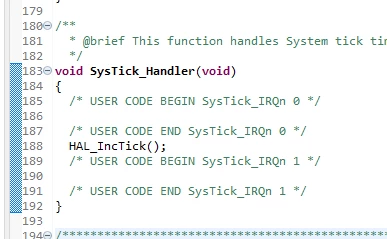

In this function is something missing ?
0693W00000aITxvQAG.pngthere is no IRQ inside this function ?

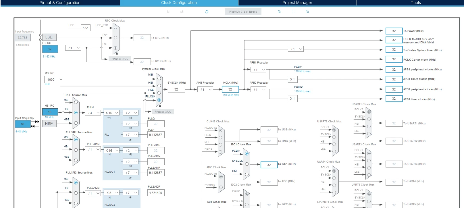

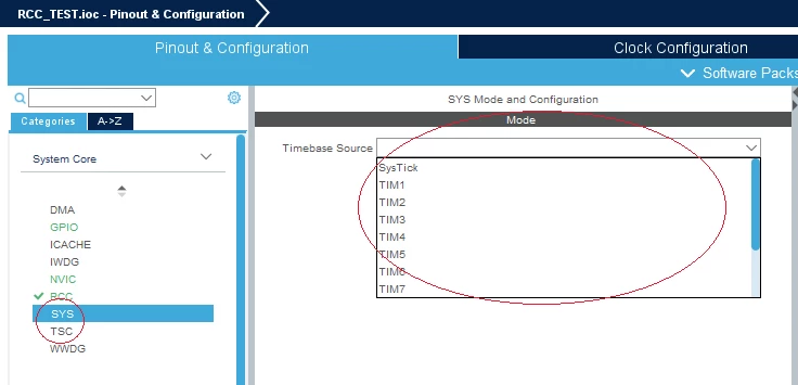

I'm not familar with the code (I'm a new user), I prefer to go through Cube IDE. I suppose it's this tab I need to activate ?
0693W00000aIUMiQAO.pngAnd I select SysTick probably ?
0693W00000aIUbRQAW.pngno parameters to be configured ? What does that mean ? I specify that I have an evaluation board STM32L552E-EV.

Thank you DYann.1.  I do have the Timebase Source set to SysTick.

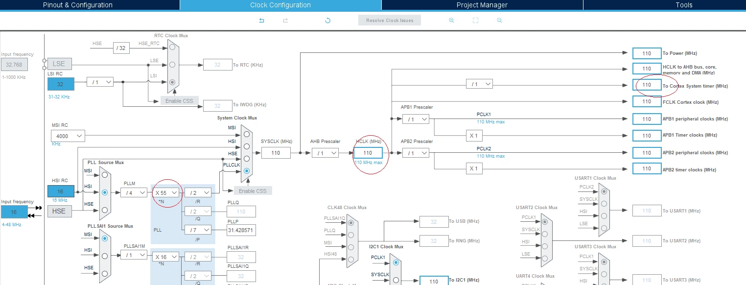

After your explanation I try to have 110 MHz, it's ok but I don't understand what do you mean prescaled clock source is DVI8 ? I have this configuration can you show me this prescaler on this picture please ?
0693W00000aIZ8KQAW.pngit seems to me that I have a prescaler of 55 to have 110 MHz.

After set a breakpoint in the function HAL_IncTick()
0693W00000aIeznQAC.pngit does not pass in this function, probably I have to write an additional code ?
