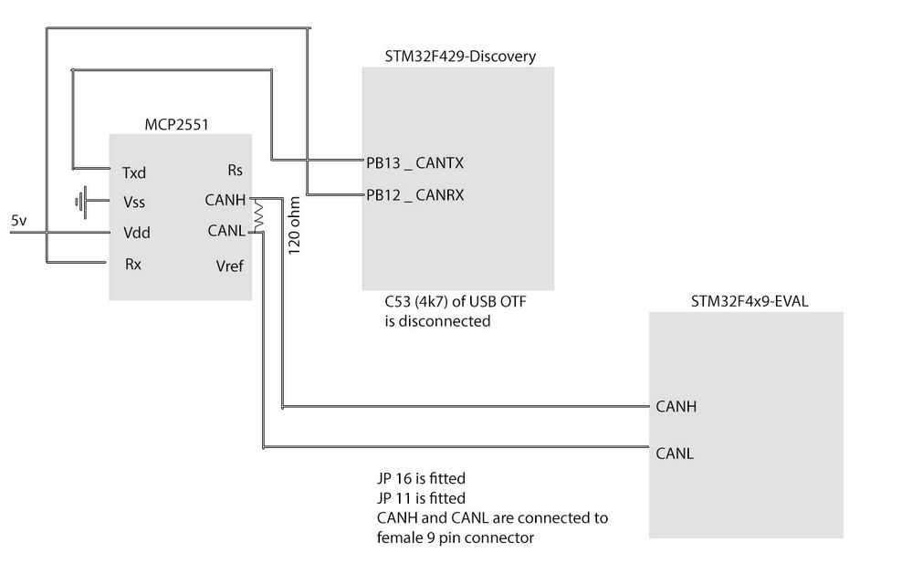

Hello, I'm trying to communicate with a STM32f4x9 EVAL board and a STM32F429-Discovery board via CAN Bus,
I am using MCP2551 transceiver IC for Discovery board, I know that CAN1 is being used by LCD and CAN2 is used by USB OTG. So I de-soldered the C53 (4k7 uf) capacitor of Discovery board (according to a video on
https://www.youtube.com/watch?v=4fYoXGiIdDs
), I have tested everything, wirings, HAL configs for CAN, etc.. But I'm getting timeout when I call the HAL_CAN_Transmit function. I am using pure STMCube examples (STM32F4x9_EVAL\Examples\CAN\CAN_Networking), I re-configured the same example for Discovery board, using CAN2 instead of CAN1. Here is my wiring schematic: 0690X000006035cQAA.jpg I did not touch the Eval example, but here is my code for Discovery board:

What am I doing wrong? It's not because I use a MCP2551 and the EVAL board is using HVD230 transceiver instead, right? It seems that the other not does not ACK the sent frame, am I right? What causes this? #transmission #stm32 #stm32f4 #can #can #error #timeout #can-timeout

Check the CAN ESR register on both sides.  It will tell you what the error code is.

Well, the timeout problem was a physical link issue, I don't remember what it was exactly (maybe the MCP2551s where broken, because I changed them), however, it is working right now.
I also tried without using transceiver ICs, page 4 of this document :
http://www.keil.com/appnotes/files/apnt_236.pdf and it worked fine.

/* ♯ ♯ -2- Configure the CAN Filter ♯ ♯ ♯ ♯ ♯ ♯ ♯ ♯ ♯ ♯ ♯ ♯ ♯ ♯ ♯ ♯ ♯ ♯ ♯ ♯ ♯ ♯ ♯ ♯ ♯ ♯ ♯ ♯ ♯ ♯ ♯ ♯ ♯ ♯ ♯ ♯ ♯ ♯ ♯ ♯ ♯ ♯ ♯ */
sFilterConfig.FilterNumber = 0,
sFilterConfig.FilterMode = CAN_FILTERMODE_IDMASK,
sFilterConfig.FilterScale = CAN_FILTERSCALE_32BIT,
sFilterConfig.FilterIdHigh = 0x0000,
sFilterConfig.FilterIdLow = 0x320, ,  ,  ,  ,  , // works with , 0x0000
sFilterConfig.FilterIdLow = 0x0000,
sFilterConfig.FilterMaskIdHigh = 0x1fff, ,  ,// works with 0x0000
sFilterConfig.FilterMaskIdLow = 0xffff, ,  , // works with 0x0000
sFilterConfig.FilterFIFOAssignment = 0,
sFilterConfig.FilterActivation = ENABLE,
sFilterConfig.BankNumber = 14,
Thanks
