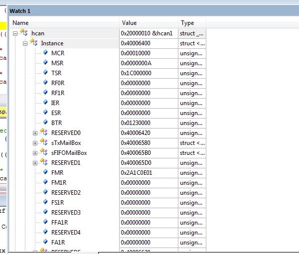

I was just started with CAN peripheral on my stm32f446re nucleo board.
The problem i am facing is HAL_CAN_Init()  added by cubeMx code generation software is failing at the below line of code
it is returning HAL_ERROR in CAN1 LOOP BACK MODE
That means the controller has not set SLAK to zero even if we clear the SLEEP bit
i believe that CAN TX is internally connected to can rx and can rx is not sampled .
on the board i have made no connection to the can tx and can rx. its just a single board.
Please let me know what i am doing wrong .

here is picture of all reg contents

You must be running without a transceiver chip.
so therefore you need a pullup on the CAN Rx pin.       <- your fix

Hello T J , ,
Thanks for replying . yes after pulling up rx line with 3.3k resistor the above problem got resolved. ,
But still i am not able to rcv the same packet sent in loop back mode. ,
The RX is not getting any packets . ,
