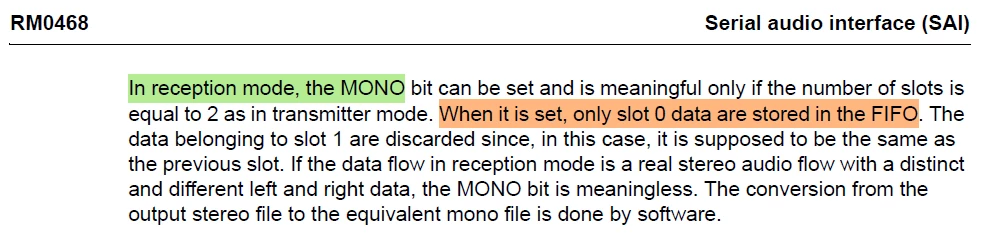

Heyho,
using all SAI blocks on H723 / H733 / H735 with stereo audio ADCs via DMA, working smoothly as long as both channels are used.
Now I wanted to implement turning off single channels, and I thought I could do that with the SAI / DMA settings.
I just found the MONO mode & bit and its limitations (RM0468 Rev 3, page 2304):
So only slot 0 (channel 1 of stereo ADC, or in audio terms: LEFT channel) can be used. (This is terrible!)
As far as I understand, the settings in register SLOTR stay the same as for stereo mode (NBSLOT = 1 and SLOTEN = 3).
DMA buffer length is set to half the stereo length.
Problem:
I still see data of channel 2 in the DMA buffer, it's changing all the time: sometimes channel 1 data only, sometimes stereo data (with the usual channel multiplexing, samples: c1 c2 c1 c2 c1 ...).
Anybody any ideas?
Thanks in advance!
LCE
LCEBest answer
Principal III
October 15, 2024
Correction:
the above is true - but not necessary.
Sometimes, just don't believe the RM...
That part is wrong, slot 0 is stored only if slot 0 is enabled (as proposed on the previous page).
If SLOTEN in SLOTR is set to 2 (slot 1 is enabled) and MONO bit is set, luckily slot 1 (= 2nd / R channel of stereo) data is given to DMA.
No FSPOL shenanigans needed! :)

It doesn't matter which SAI block is used, SAI 1 A or B or SAI 4 A or B, always the same result.

Now I get the 1st of the 2 stereo channels cleanly with the MONO bit.
Maybe I can do some LRCK polarity switching to get channel 2.
LCE
LCEAuthor
Principal III
October 15, 2024
So, for the non-master SAI blocks, I can simply switch the FSPOL bit in FRCR to get the 2nd channel in MONO.
But - as expected - I must not do that with the SAI clock master, because then all other stereo channels get switched (L becomes R, R becomes L).
I mean, I could do that, but our software guys would kill me... :D
Conclusion:
- the SAI clock master's channel 1 (or left) must always be turned on (channel 2 / R can be turned off)
- for the SAIs working as clock slaves, the FSPOL bit must be inverted to get only channel 2 / R
LCE
LCEAuthorBest answer
Principal III
October 15, 2024
Correction:
