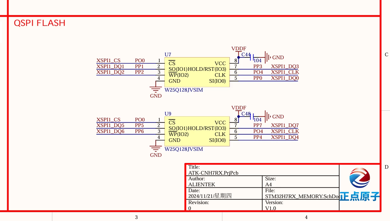

I've purchased an STM32H7R7L8HxH development board, but I'm not sure how to download a binary file to the external flash.
The external flash consists of two W25Q128 chips. The Chip Select (CS) lines of both chips are connected to XSPI1_CS PO0. The Clock (CLK) lines of both chips are connected to XSPI1_CLK PO4. The data lines (D0 - D3) of the first chip are connected to XSPI1_DQ0(PP0) to XSPI1_DQ3(PP3), while the data lines (D0 - D3) of the second chip are connected to XSPI1_DQ4(PP4) to XSPI1_DQ7(PP7).
I'm at a loss as to how to solve this issue. I've discovered that it's possible to create an external flash download project in CubeIDE, but I don't know the specific steps. In my area, many people are unfamiliar with external flash downloading.
Could you please help me? If it simplifies the process, you can focus on using just the first W25Q128 chip and ignore the second one. I'd be extremely grateful for your assistance.

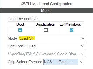

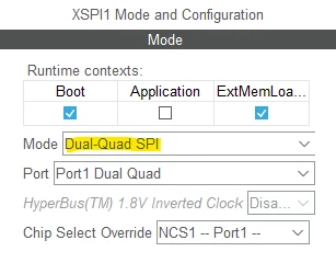

Hello @RaidenMEI;
I recommend you to look at this FAQ How to create an external flash loader for an STM32H7RS and get inspired to create your own external loader.
You need to configure the XSPI interface according to the XSPI mode used and the memory settings.
If you want to use two memories, each device uses the same CLK and NCS signals, but each has a separate IO0 to
IO3 signals. In this case, the XSPI is configured in Dual-Quad SPI mode.
If you want to use only one memory, the XSPI is configured in Quad-SPI mode.
I hope this help you.
