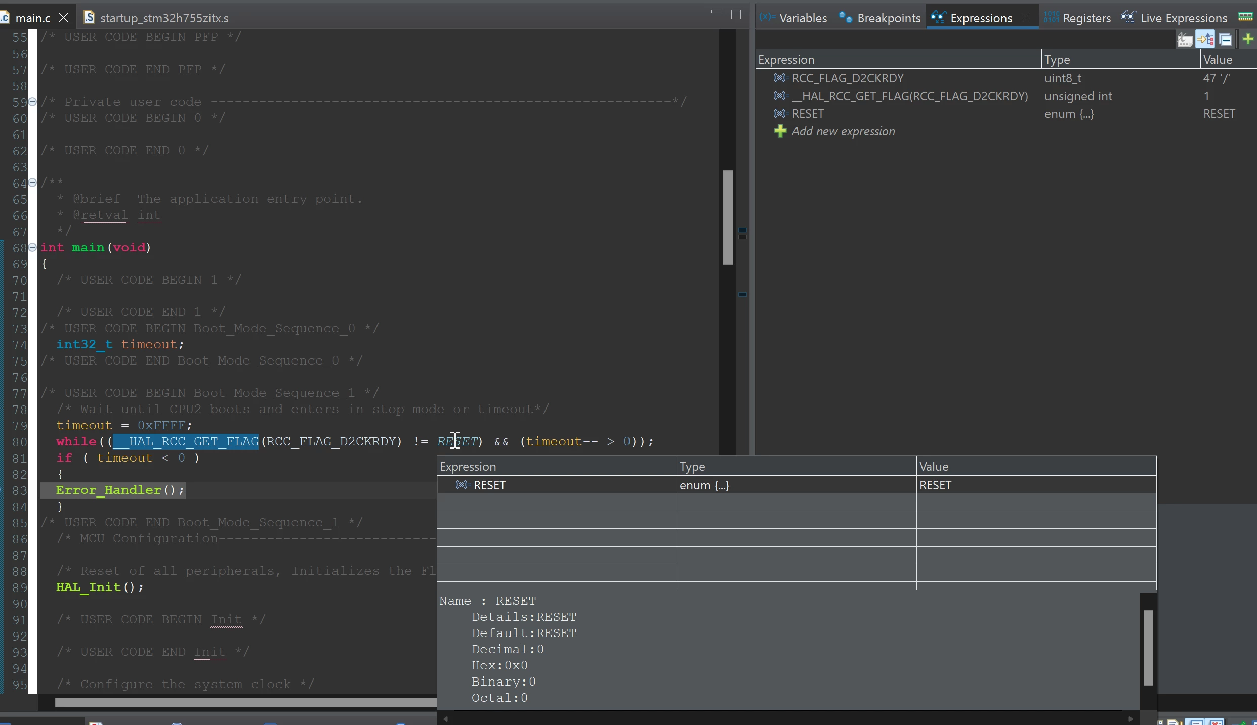

H755 Nucleo board and F769 Discovery board error handler on loading board example
I have a STM32F755ZI nucleo board. I am trying to load and run simple project from the board selector. So creating new stm32 project and selecting the board. Then i try to load the project and while it seems to load the stlink led blinks 3 colours and the load in the console goes up to finish the program goes to some error handler.

Temporary breakpoint 1, main () at ../Core/Src/main.c:107
107	 timeout = 0xFFFF;
Program received signal SIGINT, Interrupt.
0x08000712 in main () at ../Core/Src/main.c:108
108	 while((__HAL_RCC_GET_FLAG(RCC_FLAG_D2CKRDY) != RESET) && (timeout-- > 0));
0x08000720 in main () at ../Core/Src/main.c:108
What is the problem what should i check. I was using STM32CubeIde 1.14.0 and i updated ot 1.14.1 and it is the same issue.
Previously i had some project that where running properly (which i started only by MCU selection and setting the rest manually) and they have now the same problem.

Kyrpav
KyrpavAuthor
January 24, 2024
previously means one month before. as i was just making small programs based on stm tutorials.
Nothing really serious blinking leds , pwm just getting started.
I have not resoldered anything to both of the boards. i have placed pin headers in the H755 but there is no bridge there that could connect 2 different pins i have checked with multimeter.
And the problem started with 1.14 also suddently. I happens on both 2 different H755 nucleo boards and 1 F769disco board.
I have uninstalled stmcubeIde and deleted also .stmxxx folder and the repository. and reinstalled. but non helped.
What else do you thing it should be tested?
The problem is in this line:
and the rcc_get_flag is problematic until the timeout variable goes -0 and then you get error handler:

January 24, 2024
@Kyrpav I suggest you disable boot sequence to be able to debug CM7.
Here is why.
RCC_FLAG_D2CKRDY
is released by CM4. Since you are stepping in debug it could not be released at the right time.
To give better visibility on the answered topics, please click on "Best answer" on the reply which solved your issue or answered your question.Best regards,FBL
mƎALLEm
mƎALLEmBest answer
January 25, 2024
So you need to remove
 timeout = 0xFFFF;
 if ( timeout < 0 )
 Error_Handler();
and
__HAL_RCC_HSEM_CLK_ENABLE();
/*Take HSEM */
HAL_HSEM_FastTake(HSEM_ID_0);
/*Release HSEM in order to notify the CPU2(CM4)*/
HAL_HSEM_Release(HSEM_ID_0,0);
/* wait until CPU2 wakes up from stop mode */
timeout = 0xFFFF;
while((__HAL_RCC_GET_FLAG(RCC_FLAG_D2CKRDY) == RESET) && (timeout-- > 0));
if ( timeout < 0 )
Error_Handler();
  And you will be in a single core configuration or "dissociated" core config.

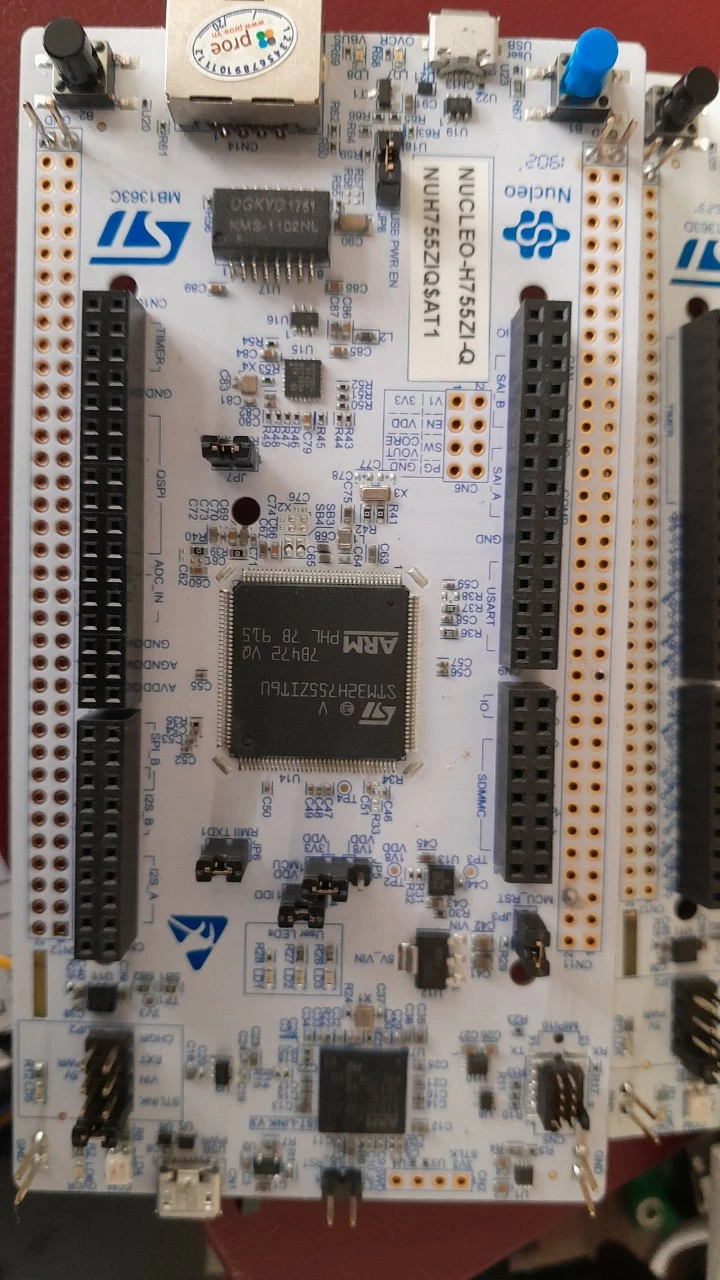

Ruồi
July 20, 2024
I had the same error with the H755 nucleo board with code NUH755ZIQ$AT3.
However, for the NUH755ZIQ$AT1 board, there is absolutely no problem.
What is the difference in these two boards? It's all NUCLEO and H755ZIT6 chip.NUH755ZIQ$AT1NUH755ZIQ$AT1NUH755ZIQ$AT3NUH755ZIQ$AT3
