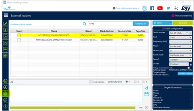

i have troubles finding the external loader for the H745I-Disco schematic. I have to admit that i drew my own board without trying it on the disco board first.
The schematic says that for two Quadspi flash ICs the MT25QL512A should be used. I have two of them on my board now.
Can anybody point me in the right direction? They seem to be missing in the official stm external loader github repository. I searched @Tesla DeLorean github and found external loaders that say they are fixed and tested on h745I-disco but they didnt work for me.
Should i switch to MT25TL512?
Also what kind of programmer should i use. I read that v2 isnt the best for dual core. Any recommendations?
Thanks in advance!!

Hello @MReus.2 ,
Could you please try to use "MT25TL01G_STM32H745I-DISCO.stldr" under STM32CubeProgrammer path "...\STM32CubeProgrammer\bin\ExternalLoader".
I think it will work because the MT25TL01G_STM32H745I-DISCO" [support memory Size = 128M] for MT25QL512A [memory Size = 64MB]. So, the size of your memory is less than the external loader supported by STM32CubeProgrammer.
Also, to create your own external loader, I advice you to start with MT25TL01G_STM32H747I-DISCO external loader and get inspired by this FAQ "How to implement and use your own external flash loader: An example using STM32U5A9J-DK"  by following the steps to create your own external loader.

After upgrading to ST-Link V3 programmer it started working with the above mentioned loader.
Thank you!!
