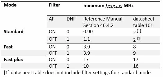

(1) Datasheet (page 183) says "the 20 mA output drive requirement in Fast-mode Plus is not supported"; Reference manual (table 370, page 1936) says it is.

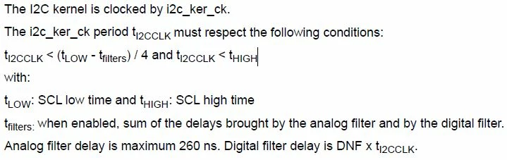

(2) Reference manual (Section 46.4.2, page 1938) gives formula for I2C kernel clock requirements (maximum period, minimum frequency):
Datasheet (table 101, page 183) has a table with values different from the predicted by that formula. I have compared the formula result (using the t_LOW and t_HIGH values from the I2C specification) with the datasheet table:
