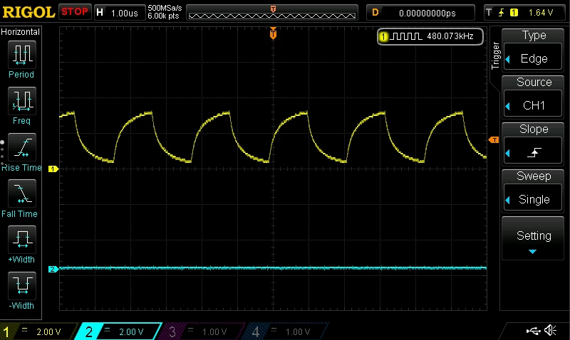

Just yesterday on my H743VIT6 (rev. V ) on the running TFT : picture faded away...white screen.
I just happened to look at the display , thinking ...ok, maybe one of the thin wires just broke now...
TFT (small, 1,8" , ST7735 on 3,3V) connected /soldered about May 2022 , on SPI2 , at 48 Mbit . :)
(Not touched/changed the wiring since then - so no static problem etc. possible.)
Today i tried to fix the problem - but everything still connected !
So took the scope to check the signals, beginning with reset ...all look ok, except SPI data !
Here super slow rise time...ok, no useful signal for the TFT at 48Mb. (PC3_3 is sick ?)
First check short to next pins - no, all free. Then impedance of pin unpowered : high, as cmos should be.
Hmmm....try other pin: in Cube could choose PC1 as SPI2 data tx , so i changed to this and soldered the wire also here. (Soldering iron is antistatic.)
Hey, TFT display ok, as before.
But was the pin the problem - after 1 1/2 years running ?? So i set it as gpio out , hi speed, and put simple gpio toggle to it, this its doing now (looks like heavy capactive loaded - but just the 20pF of scope probe there):
Seems this pin lost its drive power all by itself !

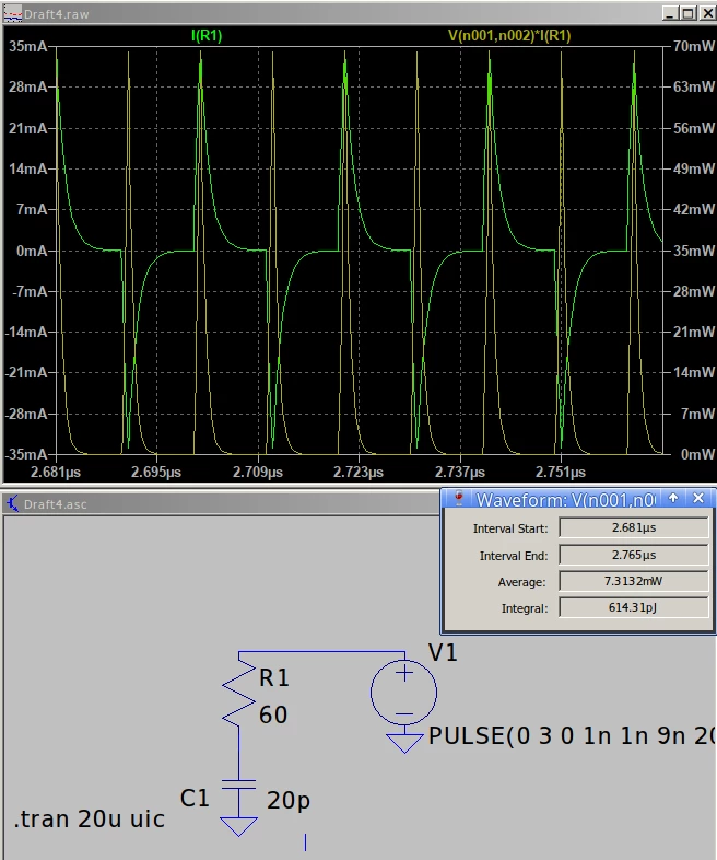

maybe i killed it -- is it very sensible to "overcurrent" (>1mA ) ?
Because i just made the write data to display a little faster on F303 with other TFT ( ILI9341 ) that day,
at first using HAL_SPI_Transmit() , needs 305 ms for a 8x10 lines grid (like a DSO sceen);
then tried direct register write : 6 ms !
Then i thought : try same on the H743 + ST7735 TFT ; after some time ( 2 hours !!!!) , i got it working (who had the idea to make this SPI so over-complicated ??? ), then it draw one screen -- and faded away forever...
So i suspect this SPI write at more speed - was too much for the tiny switch.
Simu at this speed (with 60 ohms switch) shows > 20mA peaks , and about 7mW loss :

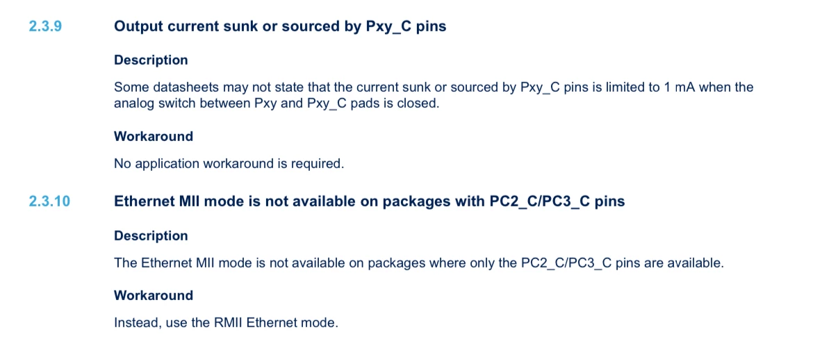

We released last year a documentation  and silicon errata on _C pin usage when configured as digital and not direct analog input for ADC .
https://www.st.com/resource/en/errata_sheet/es0445-stm32h745xig-stm32h755xi-stm32h747xig-stm32h757xi-device-errata-stmicroelectronics.pdf

My errata sheet from 6/2022 ... ok.

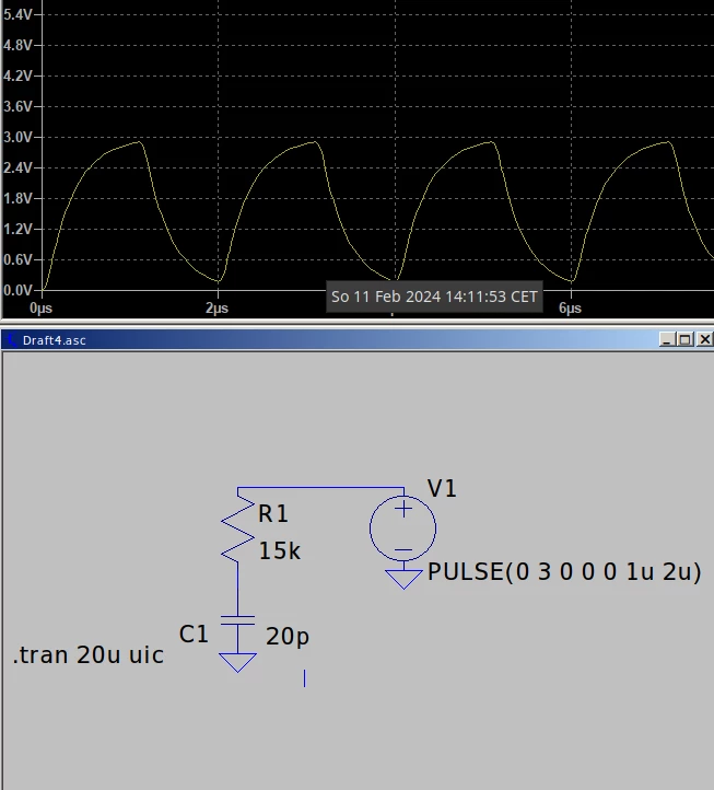

To get such a signal with 20pF load, i tried simple simu :
Looks similar - if "switch" has about 15k ohm now ! ?
What else could i check ?  Or is it just -- switch dead now, because "overload" with some 48Mbit data ?

indeed it seems the signature of the switch , may be a kind of electromigration -  How many devices are impacted please?
If possible to send it for a failure Analysis to confirm .
