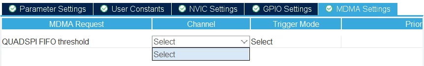

Probably easy question, I would like to use DMA with QSPI (e.g. HAL_QSPI_Receive_DMA) but STM32CubeIDE/MX (1.16.0) is not giving me any options to configure it.

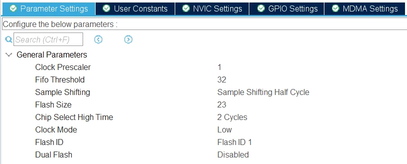

There are no options, my parameter settings are below
QSPI is working fine in Indirect/Polling mode and interrupts are enabled. This is for a STM32H743VIT,

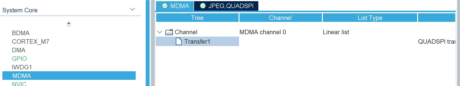

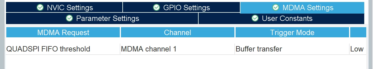

Go into the MDMA peripheral, add a channel for QSPI, and then you will be able to add it within QSPI.

I knew it would be something simple, I can only say DOH!
Thanks,
