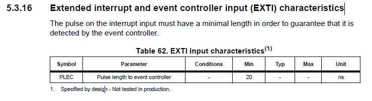

EXTI characteristics section appears to be missing from the datasheet.
Example from STM32H503xx datasheet:

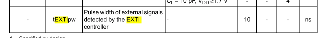

Jul 22, 2025 7:04 PM UTC
On the F4, it's 10ns. I would guess it's similar here but doesn't seem specified in the datasheet.
It is an edge detection circuit--a single event will trigger it. No digital filtering.
