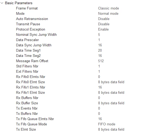

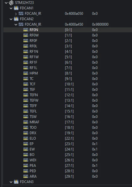

PGrif.2
PGrif.2Author
Feb 21, 2024 7:39 AM UTC
Hi SofLit,
I am using two CAN channels.
Channel 1 H723 A to L432 C
Channel2 H723 A to H723 B
Channel 1 is FDCAN1 in classic format to communicate with a STM32L432 supporting only CAN2.0 (classic) at 20kbit/s.
Channel 2 is FDCAN2 in FDCAN format to communicate with another STM32H723 supporting FDCAN at 12.5kbit/s.
I want to use both channels simultaneously (A - C and A - B) and take advantage of the higher data size of FDCAN, my understanding is that all 3 FDCAN instances are fully independend.
Changing FDCAN2 to classic as recommended shows the same behaviour at receiver B, just an CAN acknowledge no interrupt at the register:
FDCAN 2 classicFDCAN 2 classic
FDCAN2 interrupt registerFDCAN2 interrupt register
FDCAN2 classic settingsFDCAN2 classic settings
 Cheers.
