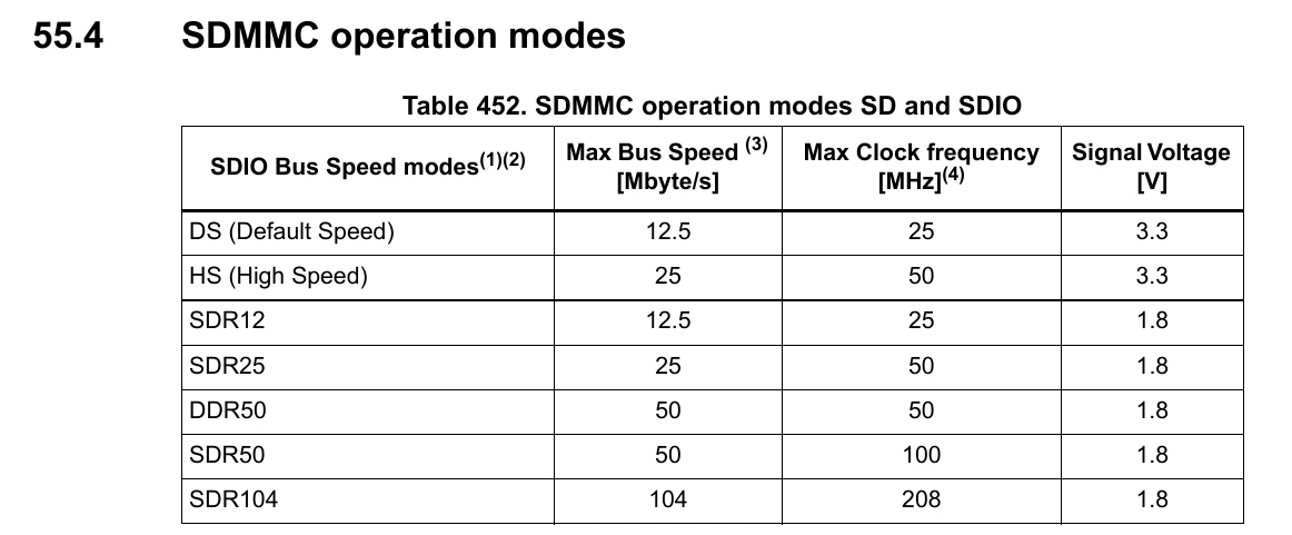

> Clock divide factor: 1 (which results in 200 MHz / (2 × 1) = 100 MHz SDMMC_CK
- is too much ! sd-card max is 50MHz , set div to 2 (or3) , to have max. 50 M .
Try first without DMA ;
if working,  then try with DMA : disable D-cache (to check, if its a problem with cache manage.)
My SD card actually supports a clock frequency up to 104 MHz, as it complies with the SDHC UHS-I SDR104 standard. when I perform SD read/write operations via the MCU using FatFs, either in blocking mode or with DMA, it works flawlessly even at 100 MHz.
However, the issue appears in the context of USB MSC, i have to reduce the SDMCC clock ot 25 MHz to perform SD read/write operations in blocking mode. otherwise, the system hangs.
fine, but my H7 needs 1.8V transceiver for this - you have this ?
at 3v3 : 50M max ...
