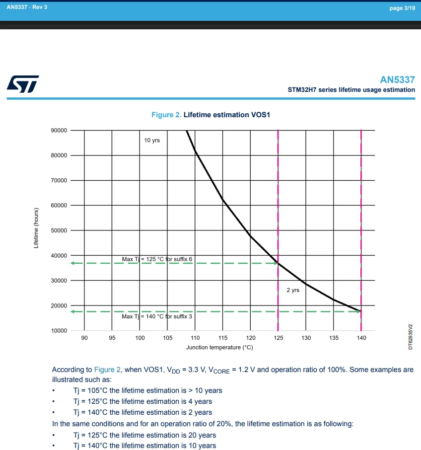

I came across this document here https://www.st.com/resource/en/application_note/dm00622045-stm32h7-series-lifetime-estimates-stmicroelectronics.pdf
We have a H75x custom board running the MCU in VOS1 at 400MHz with external 1.2V core power supply.
According to this description here
According to Figure 2, when VOS1, VDD = 3.3 V, VCORE = 1.2 V and operation ratio of 100%. Some examples are
illustrated such as:
• Tj = 105°C the lifetime estimation is > 10 years
• Tj = 125°C the lifetime estimation is 4 years
• Tj = 140°C the lifetime estimation is 2 years
In the same conditions and for an operation ratio of 20%, the lifetime estimation is as following:
• Tj = 125°C the lifetime estimation is 20 years
• Tj = 140°C the lifetime estimation is 10 years
the power consumption, heat dissipation and lifetime is influenced by "operation ratio". What does operation ratio mean and how can I influence/control it? Does this mean that only a part of chip silicon is powered/used? Or time spent in the idle loop, assuming the MCU is running in lowest VOS mode and/or clock frequency during idle time?
I would expect this term to mean the relative time of the system operating at given temperature.
Higher temperatures and higher currents cause electromigration (migration of n-/p- doping atoms), which degrades the die structures over time.
Mind you, these are all statistical measures.
And second, the key temperature here is Tj, not Ta.

So this:
https://www.st.com/resource/en/application_note/dm00622045-stm32h7-series-lifetime-estimates-stmicroelectronics.pdf#page=4
Indeed, the term "operation ratio" is vague and needs proper definition.
I guess it's some sort of "duty cycle": presumably, the 20% indicates the proportion of time operating at the high junction temperature - but what is happening in the other 80% of the time?
Presumably it would also depend on how long the high temperature is maintained?

I tend to agree with you. After all, this is one of those documents that create more questions than give answers... :)
I wonder what happens to the chip if lifetime is over? MCU clock stutters (but nobody cares about), flash bits are worn out, chip goes up in flames, ...?
So the primary goal in order to save lifetime is to keep the junction temperature below 125°C?
This can be acchieved via power consumption reduction and chip cooling. Latter is hard to do.
Power consumption is proportional to MCU core voltage, clock frequency, active silicon, ...
But is switching VOS levels, frequency and turning on/off temporarily unused peripherals really a practical way to go in an industrial application? I guess most applications nowadays are still running a super loop at VOS0. What happens? Never heard about failing systems due to running at CPU maximum clock speed. Is this only STM business?
Very few industrial applications have an estimated lifespan of 10 years, technological obsolescence usually hits earlier.
Automotive applications are different, they often require qualification at much higher ambient temperatures. And you would need to add about 10 to 30°C between Ta and Tj.
