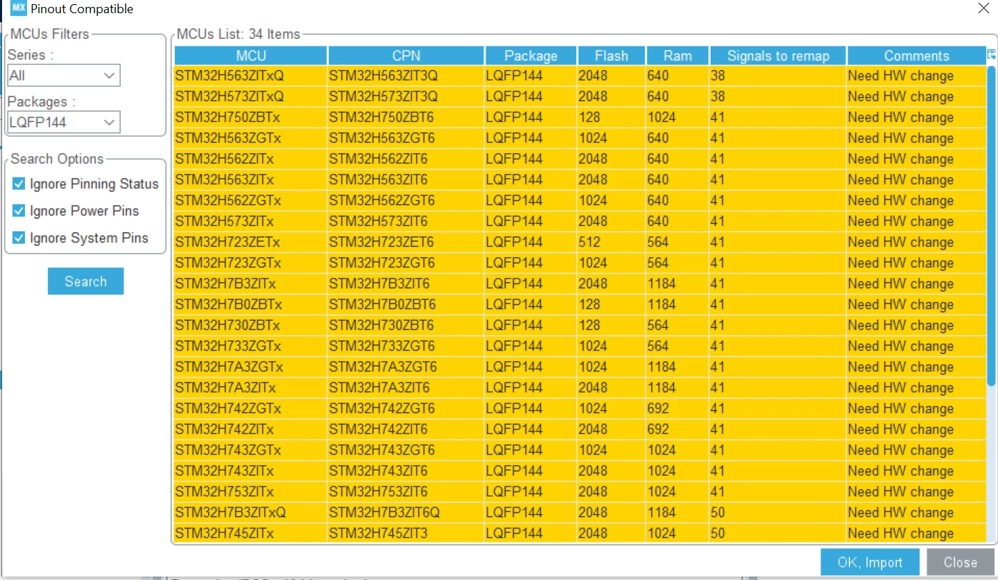

I was just shocked to see that H723 and H735 are NOT pin-to-pin compatible, at least in LQFP-144.
Shoot, I thought I could switch between H723 / 725 / 733 / 735 if necessary.
I found the list for F4 / F7 / H7 compatibility, is there another list for compatibility within the H7 families?
TDKBest answer
Oct 6, 2023 1:15 PM UTC

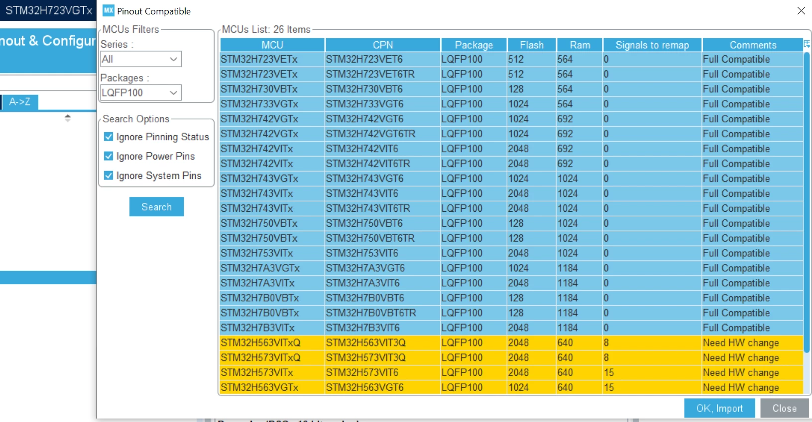

CubeMX will list pin-compatible parts. Load your chip, configure it if you want, then go to Pinout -> List Pinout Compatible MCUs.

Okay, I just found that package compatibility is between H723 and H733, and again between H725 and H735.
What about H7A / B ?
Anyway, an official list would help.

@TDK thanks for the hint, but for a quick check that takes too long - at least my CubeMX always needs some time.

You can use CubeMX Pinout compatible feature to find the list of pin-to-pin compatible MCUs.
