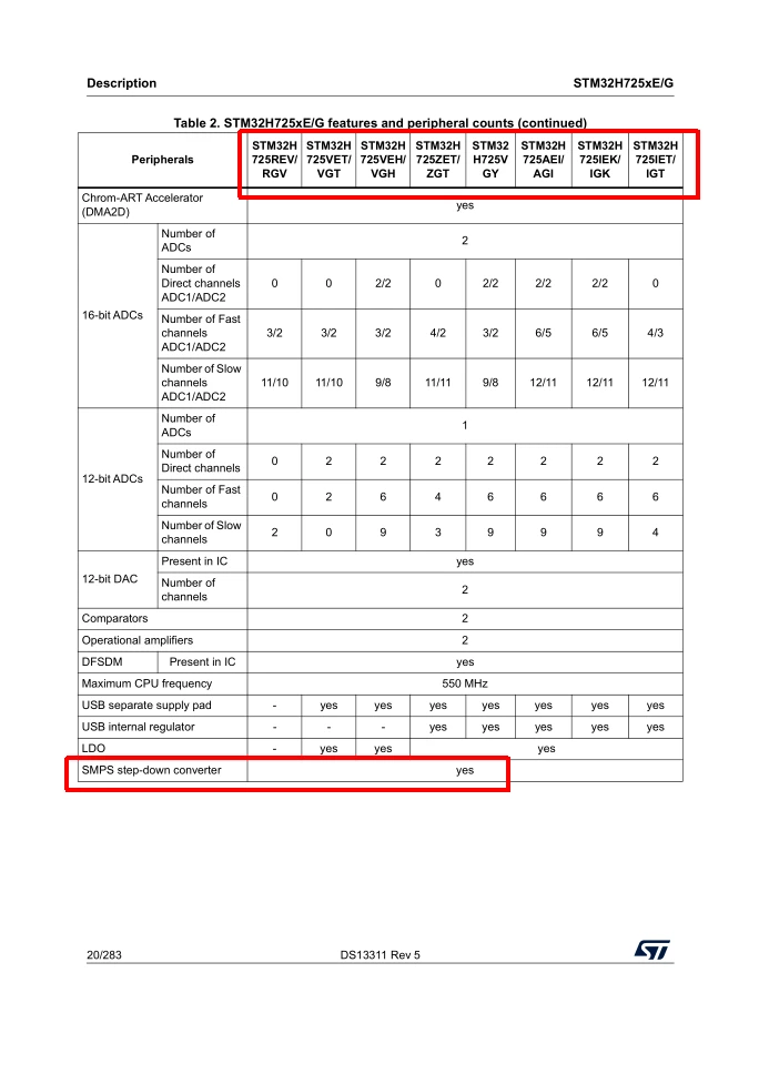

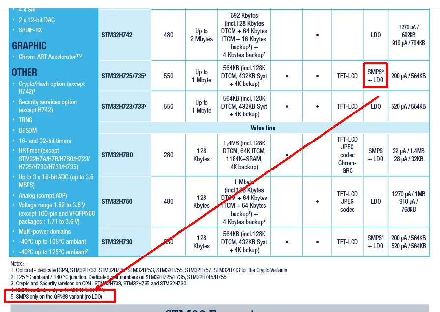

'H7 infographics: SMPS in 'H725?
DS says otherwise - that SMPS is available in *all* packages for 'H725:
To me it appears that it's the infographics which is wrong. Wasn't the footnote supposed to go into some other sub-family?

STTwo-32
Feb 26, 2024 9:32 AM UTC
Sorry for my mistake. After a deep check, I find out that the (5) note means that on the QFN68 is the only package that just include SMPS only and not SMPS and LDO which is compatible with the table 2 of the datasheet.
Sorry again for this error.
Best Regards.
STTwo-32
AScha.3
Feb 26, 2024 9:42 AM UTC
@STTwo-32 ,
> I find out that the (5) note means ...
Wouldn't it be a good idea, just to write , what it should mean, in simple words ?
e.g
5. no LDO, only SMPS on QFN68 variant .
waclawek.jan
Feb 26, 2024 9:52 AM UTC
I'd vote for this formulation, too.
@STTwo-32, as witnessed by yourself above, the current formulation is ambiguous and potentially misleading.

STTwo-32
Mar 7, 2024 7:56 AM UTC
Hello @waclawek.jan @AScha.3
The infographic it's going to be updated on the coming Months and your recommendations will be considered on this update.
Best Regards.
STTwo-32
STTwo-32
STTwo-32Best answer
Mar 25, 2024 7:34 AM UTC
The STM32H7 web page has been updated and the confusion you have mentioned has been removed.
Best Regards.
STTwo-32
