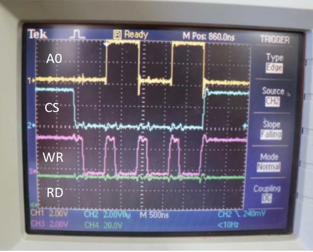

if someone can tell me how to write a byte to a FMC memory ?

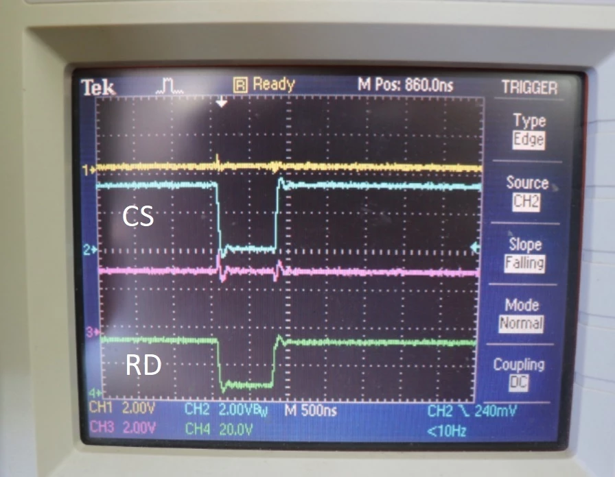

Reading a 16bit word looks correct and I can read the status correctly
but using A0 as register select, this is writing one 16bit word,
it seems to write 4 times, A0 is jumping up and down,
It doesn't work on my external LCD chip.

Yes, the Data cache is turned off.
will check your link,
yes it is fixed now.
thanks for that
