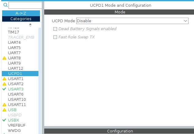

Folks,
I started off with the H573i discovery board demo as reference for the MSC + SD card (with ThreadX).
I don't have the Discovery board since in my application I needed those CC1, CC2 USBPD pins for something else.  So I ran a board of my own (using the H563ZIT6).  I'm using just micro-USB B connector, not USB-C.
I set up the project in Cube and pulled in all the segments from the demo for H573I.
But in CubeMX I have to disable the UCPD in order to get access the two pins I need.
I just left the USB enabled.
But it seems that there is no USB library setup properly if the UCPD is disabled.
Can someone tell me how to get the demo from the H573 to work if the CC1, CC2 pins are disabled in Cube and assigned as GPIO?
I don't have to have the ThreadX but figured it might be helpful as my product develops.
Thanks!

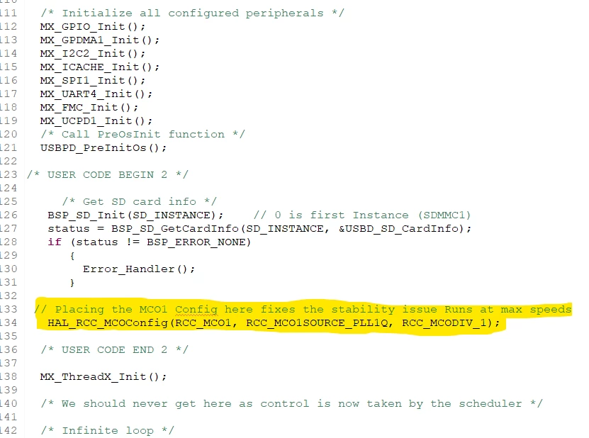

Best answer by VT_Jim
@Nicolas P. @FBL I found the issue - one step further.  CubeMX defaults the IO Speed setting for the MCO1 pin to low speed when it is enabled within the pin config (chip map).  This is done in the MX_GPIO_Init.  But the setting for the SystemClock is done BEFORE this MX_GPIO_Init.
So the fast IO pin type setting of the SystemClock_Config gets overwritten with a Slow output setting for the pin.
I just put into the user code space another call to set the GPIO very fast again after.
But this is worth a look by ST that you may want the tool to determine for the user which IO speed mode the pin assignment should be in based on what clocking speed they have configured in the Clock setup tool, or the MCO should be left alone when you get to your MX_GPIO_Init.

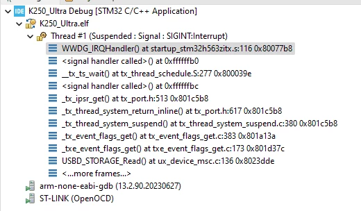

@AScha.3  I need to have this look like a microSD card reader to the user, but it is a memory controller device for a musical instrument.  Files get put into the SD via the USB.
I have tested the SD (SDMMC1) is working fine.  It reads my cards.  I have also gotten the USB to show up on my PC as MSC device but with failure.  The event logs for Windows show that the USB has the correct Vendor ID, etc.
But ThreadX crashes on me the moment I connect the USB cable.
I selected to not use VBUS sensing.  My device is self powered and doesn't use the power from USB.
I had to manually add the line of code to initialize the RPU (pull up) on D+
So far, after more than a day of debugging, I know that drivers and event handlers are not working if the UCPD is not enabled.  But if I enable it, i lose the pins I need.
Can these H563/573 chips be used with the older USB ports without the UCPD (power delivery) and work within the CubeMX setup framework?
The IRQHandler is missing for something I believe.  But not sure how to tell which one?
AScha.3
April 4, 2024
I dont understand . :)
But dont start/use WWDG , its just a funny problem more, until your prog is working fine. THEN use watchdog.
Yes, you can use "old" library without Azure - if you prefer. But it should work with rtos also.

This is going to sound crazy but - I went into Cube and told it I have the UCPD peripheral and lost my two pins (CC1,CC2) that I wanted for something else.
I recompiled and it still had the same crash, same problem.
I tried reverting in CubeMX to compare which files changed.
I then went back to Cube and enabled the UCPD again and then compiled again.
This time it worked!  I have the SD + the MSC finally working properly.
There has to be some kind of issue over the order or sequence of setting things up that doesn't configure things correctly.
I've committed a working copy and will see if I can narrow down what it was that changed in this process.
Such a huge sigh of relief however.  I thought i was going to have to make a new board spin just to switch to USB-C for this chip.
Thanks for your help along the way in this!

@Nicolas P. @FBL Question about the MCO1 signal output.  In my application I started it off at 20MHz output.  That worked perfectly.  Clean square-wave.   When I tried to go to 40MHz, the signal drops to only 300mV vs the 3V swing I get when at 20MHz.  I even removed a resistor I have in series with the output and probed the resistor pad.  I stepped through the divider range for the MCO1 output with using the PLL as the source.  At DIV10, great, DIV8, great, then at around DIV6, it becomes very strange and stalls to a very low output voltage on the pin.  All other aspects of operation in the system seem to continue to work normally.  So far it seems it is just the MCO1 pin that has an issue.  I can't find anything in the data sheets yet that would indicate that it is not meant for outputs over ~ 30MHz or so.  Can you think of what might make it drop the voltage swing level like this when under no load?
I will be using this MCO1 to clock a small FPGA that runs beside the STM32H563.
I was hoping to be able to clock up to about 100MHz if I can using that pin.
VT_JimAuthor
April 5, 2024
@Nicolas P. @FBL Found the issue solution for the MCO1 startup.
If I use it as configured out of CubeMX, it places the MCO division and source setup in the SystemClock_Config which is the very first thing on code startup.
There is some kind of internal problem where this MCO port fails to work correctly.
However - if I place the MCO config after the other peripherals are started at this location below, it works every time all the way up to my PLL1QCLK of 200MHz.  So either some other Init after SystemClock messes it up or there is a need for added delay before this MCO1 can start at all speeds.  When it failed out of Cube, it is at the correct  frequency but very low level.  at below about 25MHz it was working correctly out of Cube.
