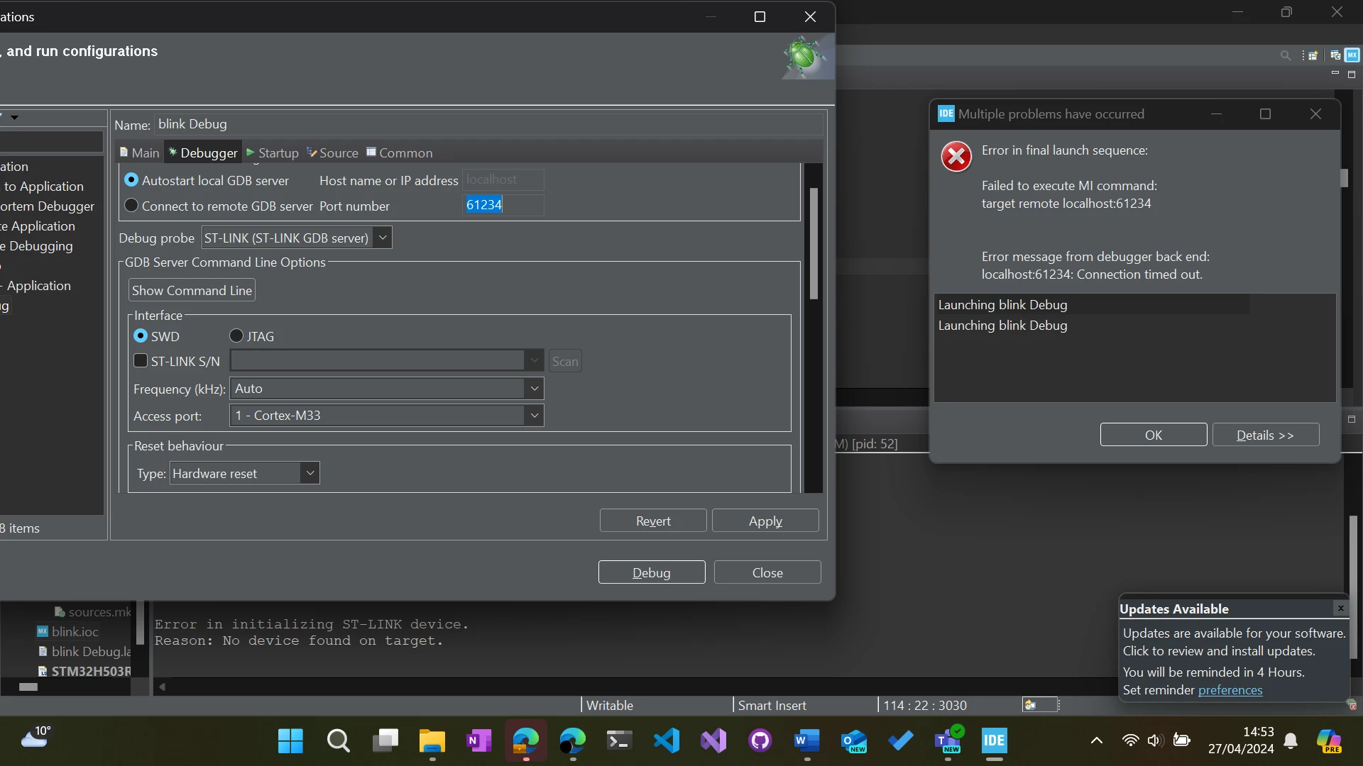

h503 nucleo 64 can't upload code - Failed to execute MI command
Thew board was working fine until i tried to get serial working over virtual COM. I'm not sure what ive done but now im receiving this message
Error in final launch sequence: Failed to execute MI command: load C:\\Users\\Ki\\STM32CubeIDE\\workspace_H503\\blink\\Debug\\blink.elf Error message from debugger back end: Error finishing flash operation
Is there a way to reset the board? or have I bricked it.
It still talks to the link utility in the IDE and says it needed an update which completed successfully.
Sorry Im a bit lost and would appreciate some guidance.
I can provide more info if needed
Thanks in advance

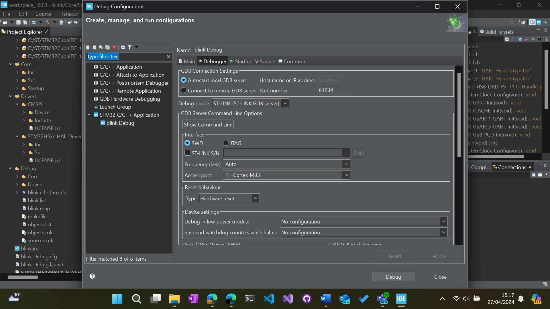

Now check IDE debug settings : also ->
If still not working here in IDE, you wrote some "strange" things to the H503, so try then:
connect with CubeProgrammer again , erase full chip - but be careful, not to do any bad action with the readout protection ! (read in rm first...you can "kill" the chip here - responding never anymore . warning ! )

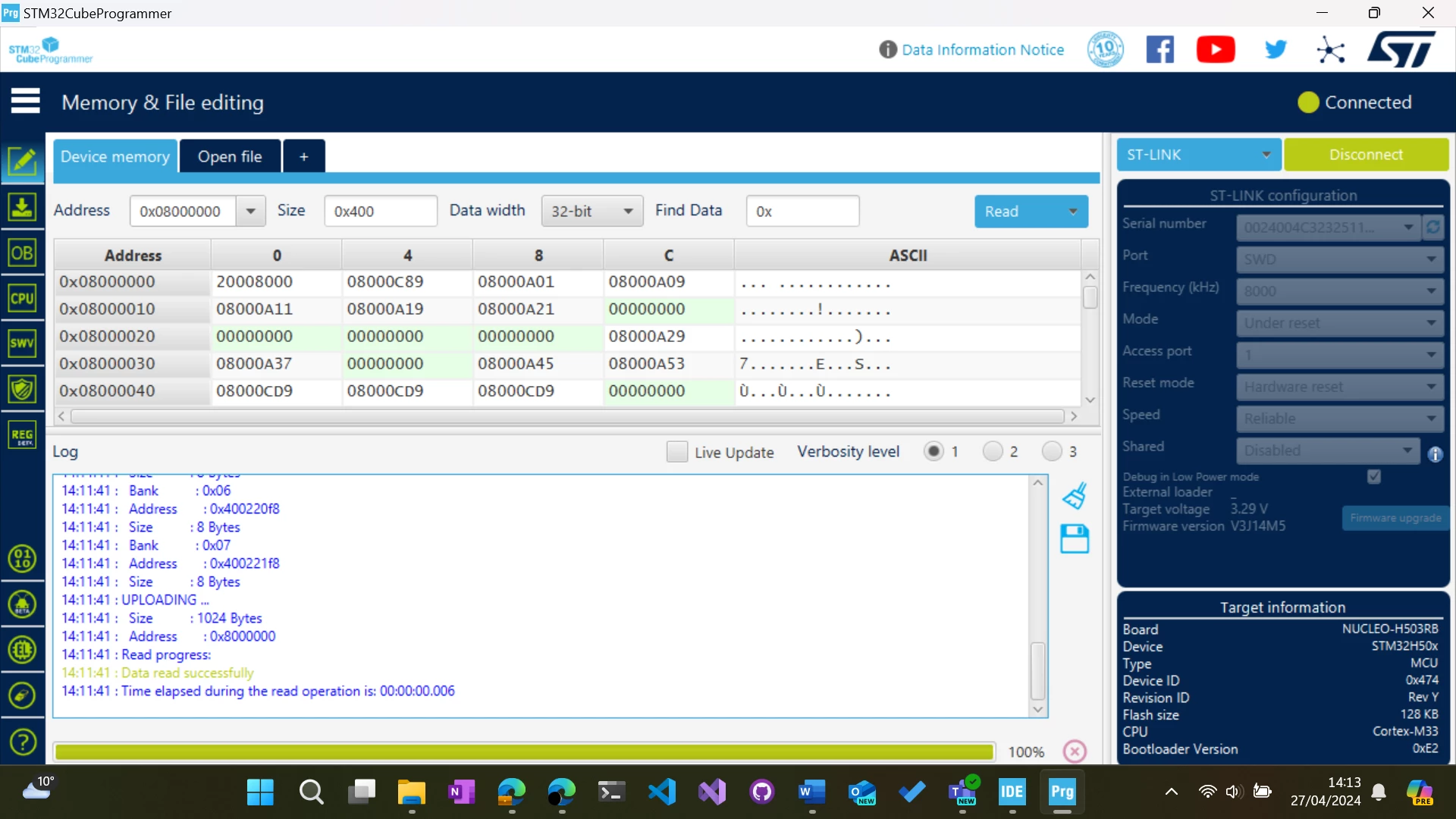

Try with CubeProgrammer , set mode "under reset" , reset "hardware reset" , connect ;
then show , what it tells (screenshot).

14:10:52 : STM32CubeProgrammer API v2.16.0 | Windows-64Bits
14:11:41 : UR connection mode is defined with the HWrst reset mode
14:11:41 : ST-LINK SN : 0024004C3232511639353236
14:11:41 : ST-LINK FW : V3J14M5
14:11:41 : Board : NUCLEO-H503RB
14:11:41 : Voltage : 3.30V
14:11:41 : Warning: Connection to AP 0 requested and failed, Connection established with AP 1
14:11:41 : SWD freq : 8000 KHz
14:11:41 : Connect mode: Under Reset
14:11:41 : Reset mode : Hardware reset
14:11:41 : Device ID : 0x474
14:11:41 : Revision ID : Rev Y
14:11:41 : Debug in Low Power mode enabled.
14:11:41 : SFSP Version: v1.4.0
14:11:41 : UPLOADING OPTION BYTES DATA ...
14:11:41 : Bank : 0x00
14:11:41 : Address : 0x40022050
14:11:41 : Size : 112 Bytes
14:11:41 : Bank : 0x01
14:11:41 : Address : 0x40022070
14:11:41 : Size : 8 Bytes
14:11:41 : Bank : 0x02
14:11:41 : Address : 0x40022080
14:11:41 : Bank : 0x03
14:11:41 : Address : 0x400220e8
14:11:41 : Bank : 0x04
14:11:41 : Address : 0x400221e8
14:11:41 : Bank : 0x05
14:11:41 : Address : 0x40022090
14:11:41 : Bank : 0x06
14:11:41 : Address : 0x400220f8
14:11:41 : Bank : 0x07
14:11:41 : Address : 0x400221f8
14:11:41 : UPLOADING ...
14:11:41 : Size : 1024 Bytes
14:11:41 : Address : 0x8000000
14:11:41 : Read progress:
14:11:41 : Data read successfully
14:11:41 : Time elapsed during the read operation is: 00:00:00.006
Thanks so much for the reply
Is this helpful?

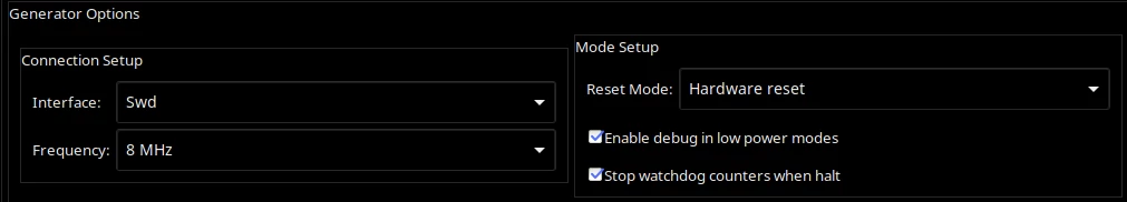

I have made the changes and I'm getting a different error now.
Frequency was auto and reset behavior was connect under reset
KDT85Author
April 27, 2024
I've been playing with these settings and this combination seems to work!
Thank you so much :)
