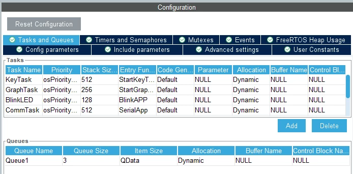

Hi to everybody.
I've developed an application using FreeRTOS, under M3 Series.
Then moved to M4 without probelms. In CubeMX I can add all the tasks, timers, Mutex and so on.
Now I'm porting to H5 MCU, but the freertos disappear from CubeMX. I found the X-CUBE-FREERTOS, where I must select "something" as this:
I really donnow why Heap_4 (not 3 or 5), and that is TZ_Not Supported.
But now? How I can I reuse my old source w/o revrite everythig?
Is what I did correct? Why H5 is different between M3/M4?
Thanks!
1 reply
January 29, 2024
Hello @TheRaprus
X-CUBE-FREERTOS provides a full integration of the FreeRTOS kernel in the STM32Cube environment for the STM32H5 series, STM32C0 series, STM32U5 series, and STM32WBA series (newer series, not related to Cortex)
You can download X-Cube-FREERTOS, and you can find examples with configured .ioc files
