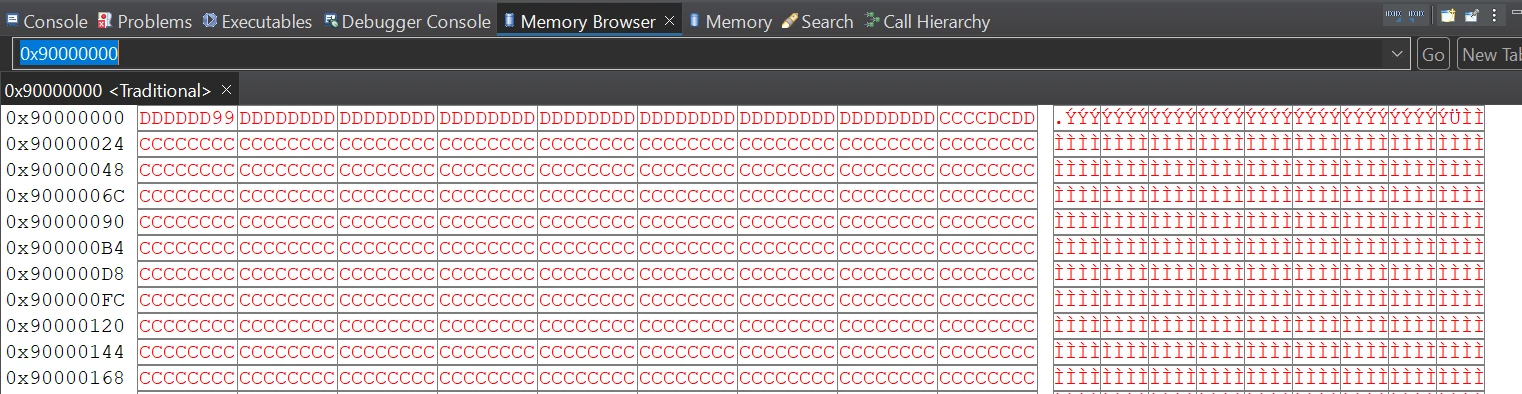

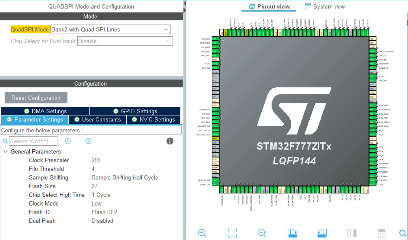

Hello I am in the task of adding a new flash as an external flash via QSPI interface with the MCU STM32F777ZITx.
The flash that I want to add is S25FL256L as an external flash. I am not finding any references which I can use with this flash. Also it is not getting clear to me whether I need to make an external loader for mapping the external flash in memory mapped mode or only configuration is needed ?

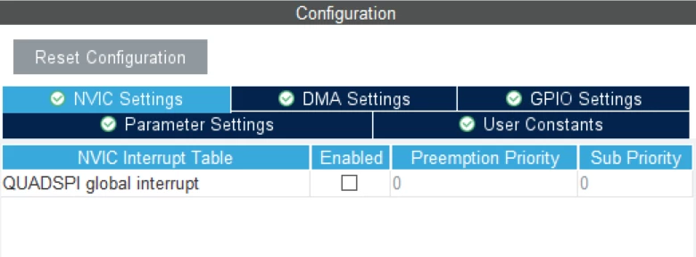

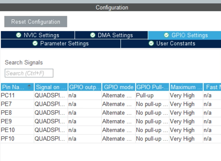

I am facing this problem where the call to the CSP_QSPI_EnableMemoryMappedMode does not fail but the external flash looks like this even after writing something

Yours looks like the memory mapping still isn't working, and the access to 0x90000000 is faulting.
