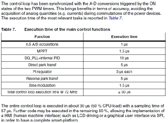

I have problem with adc sampling and controller calculating at each period of sampling(each sampling time) .I fond this from st,com . I have some questions :
1.what is the meaning of first line exactly and how I can implement it?
2. How can we calculate the time of each code like table?
3. How can we calculate(or set) sampling time like after table(57us)?
    1 reply

    This lacks context, can you please cite a link to the document and any related code/threads. Indicate the STM32 model, and board you are using.
