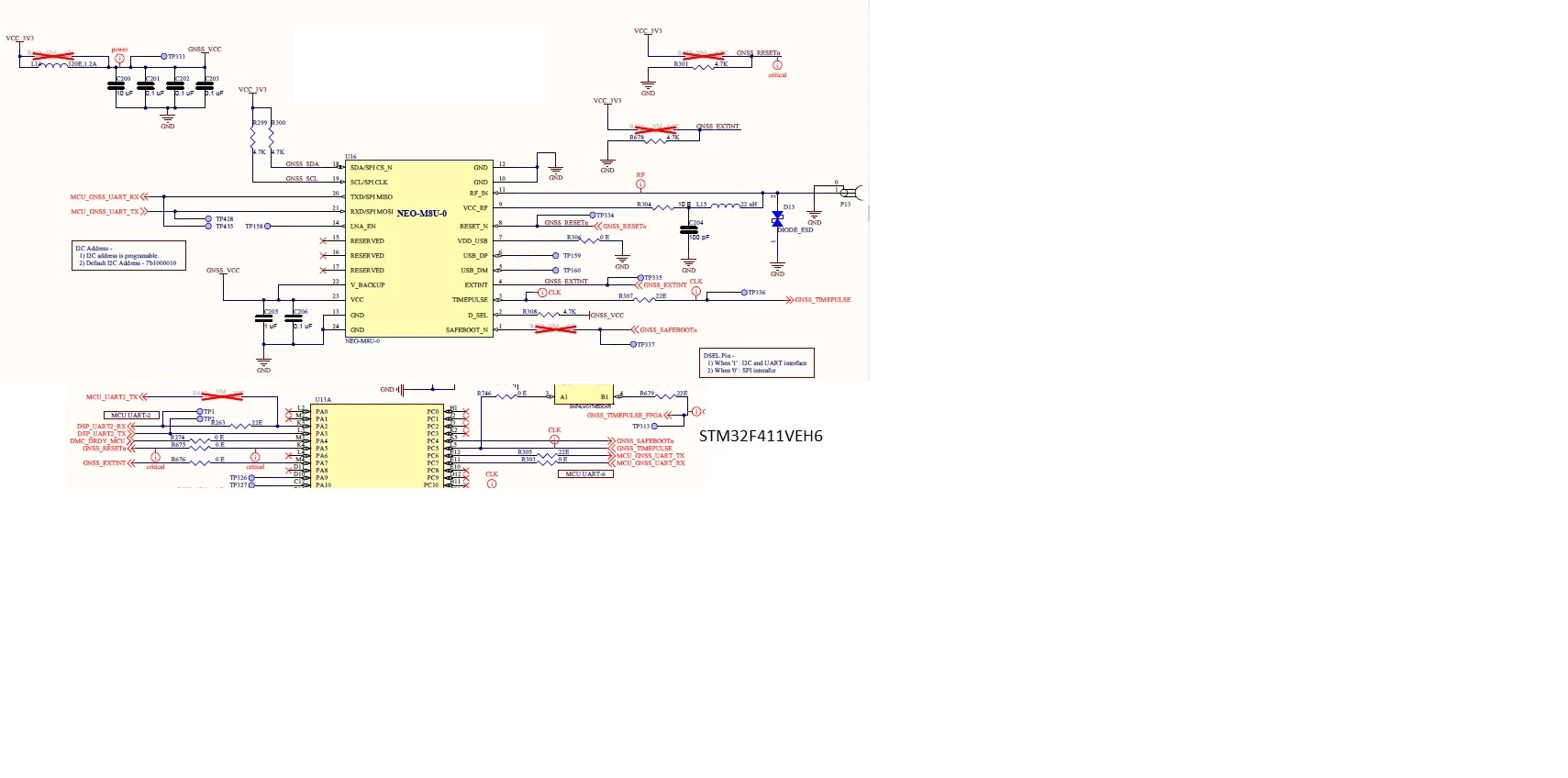

I am using NEO M8U as GPS sensor in our custom board.
GPS data is has to be collected using UART6 of MCU(STM32F411VEH6). Signal names in schematics as (MCU_GNSS_UART_TX and MCU_GNSS_UART_RX).
Code has been attached . I am unable to receive data. I am suspecting some configuration issue of UART6.
Kindly suggest.

Please try to crop images appropriately, this was unusable on my android
Don't pull RESETn LOW, also don't drive it with a Push-Pull Driver. Should be pulled high, and clamped low with open-drain if required.
You could also try disconnecting RESET if the part isn't starting properly.
RX/TX look good. Should be able to scope data bursts on NEO-M8U TX pin, defaults should be 9600 8N1 with a grouping of NMEA sentences.

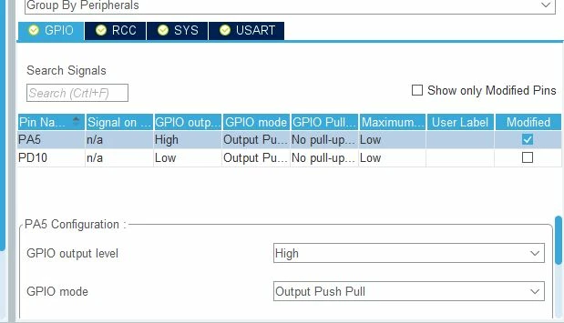

Thanks for suggestion.
Actually I am not using any GPIO out for RESETn to NEO M8U .
Now I have added a GPIO out pin (PA5) in STM32, which is used as RESETn and made output level as "High" as shown in figure.

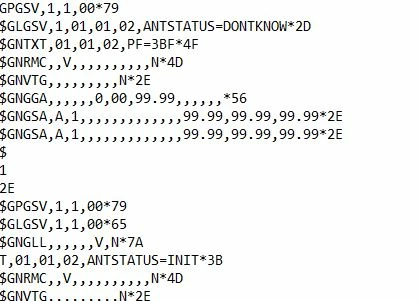

After that I am able to receive some data. But actual datas are missing.
output file is also attached.
Kindly suggest.

That's kind of indicative of not having a fix.
You might expect it to take 30-45 second to get a fix if the antenna is working properly, and it has a clear view of the sky.
What did I say about RESET using a Push-Pull driver?
