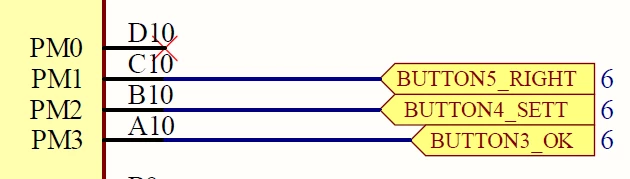

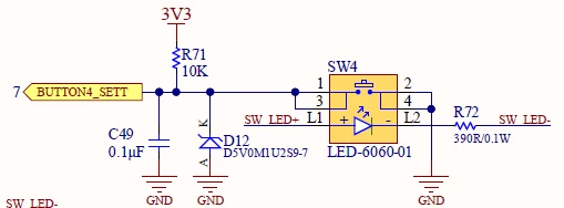

We have implemented a total of five push buttons—two connected to Port E and three connected to Port M.
The GPIOs of Port E are functioning correctly. However, the GPIOs of the push buttons on Port M are not being detected properly by the MCU.
Even when the switches are unpressed, the MCU is detecting a Pressed condition.
PORT M GPIO Pin out: PM1, PM2, PM3.
MCU part: #STM32H7R7L8H6H
I have checked  push button from hardware side, its working fine.
Attached example schematic snapshot of push button.
Could you please advise if there are any specific settings or configurations required for Port M GPIO to function correctly?

AScha.3
October 6, 2025
Some pins have alternative functions, see ds pin description.
So maybe you "found out" this on PMx :
---> disable it : set UCPD_DBDIS

Andrew Neil
Andrew NeilBest answer
October 6, 2025
@Kaushik1 wrote:
Where i can find UCPD_DBDIS option. Can you please know the location of that.
It tells you in the screenshot which @AScha.3 posted:
