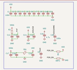

GPIO Trouble on STM32 F767ZI
I used a Nucleo F767ZI dev board to check and write firmware
(The IC on the board is STM32F767ZIT6U with the other characters being AA 254 VQ Z on first line and TWN AA 341 on line 2),
when I use HSI clock I am able to operate PD7, PG9, PG10, PG11, PG12 as an input or output GPIO
But on the custom developed board (the IC on the board is STM32F767ZIT6 with the other characters being AA108 VQ on the first line and TWN AA 334 on line two)
In this custom developed board while I am able to Program and debug the board and I am able to use all other pins except PD7, PG9, PG10, PG11, PG121)
1)The DC resistance of each of the above mentioned Pin and VCC(3V3) is infinite and same is with GND is also infinite
2) When I configure any of these Pins as GPIO Output as PUSH PULL and low speed mode then I see when I set the GPIO I see as the ODR setting but when I measure the voltage on the connecter(nothing between the connecter and the MCU Pin and tack length is less than 5 cms) i see 0.5 to 0.6V
3) When I configure any of these pins as Input with no Internal Pull or Pull Down, I see that these pins are not affected by noise where as other working pins are and if I connected 3V3 from a jumper cable to read input as logic High even that fails other than these 5 pins all other pins are working as expected.
Please help to debug the issue.

Chris21Best answer
Oct 15, 2024 6:51 PM UTC
This seems very likely to be involved:
"The VDDSDMMC is an independent power supply for SDMMC2 peripheral IOs (PD6, PD7,
PG9..12). It can be connected either to V DD or an external independent power supply."

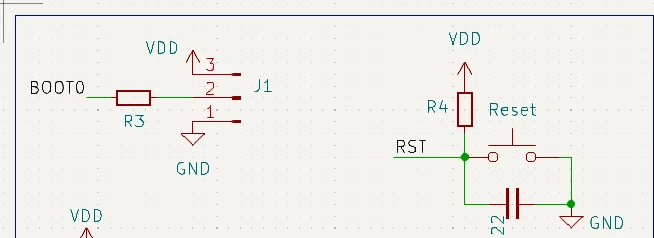

Andrew Neil
Oct 14, 2024 6:15 PM UTC
Please provide the schematics for this board.
Oct 15, 2024 5:43 AM UTC
Hi @Andrew Neil , please find the schematic
I am able to Program the board,
GPIO Clock are defined (generated by Cube MX) properly, I am able to use all pins other than the 5 mentioned above.
There is no extra component between the Pins and the connector and the length of each trace is also less than 6 to 7 cms. There is proper connectivity between the MCU pins and the connector Pads and Infinite DC Resistance between the MCU Pins and VCC, also between MCU Pins and GND
Surprisingly all 5 pins that don't work are connected between C28 and C6
Oct 15, 2024 5:45 AM UTC
@Andrew Neil  Thank you for your time on this problem, if you need anything else to have a better understanding, please let me know.

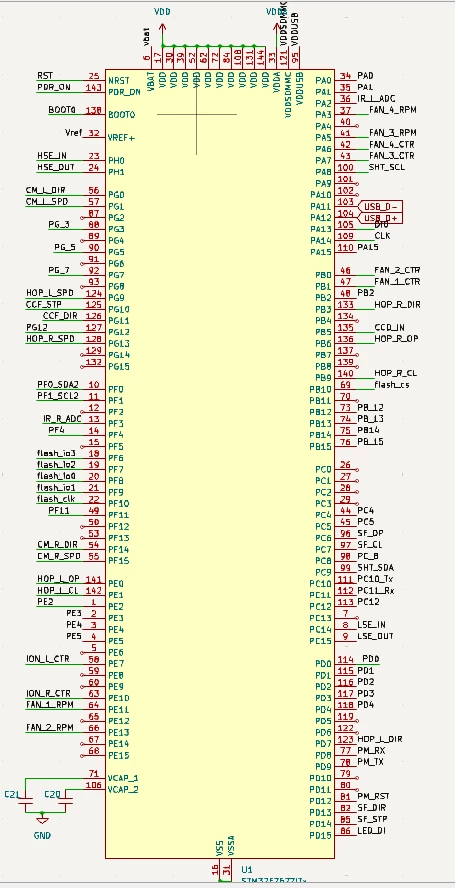

Andrew Neil
Oct 15, 2024 9:18 AM UTC
That's not a schematic - it doesn't show what is actually connected to the processor pins
Oct 15, 2024 9:32 AM UTC

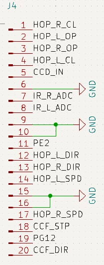

@Andrew Neil Please find the required schematic parts for complete reference
. There is nothing between the MCU pin and the connector

So all these 5 pins are connected directly to the connector.
1) Have you removed the connector and then tested the GPIOs ?
2) Maybe the board / connector had some ESD stress? Was it assembled / used in an ESD-safe environment?
3) Do you have another board to check?

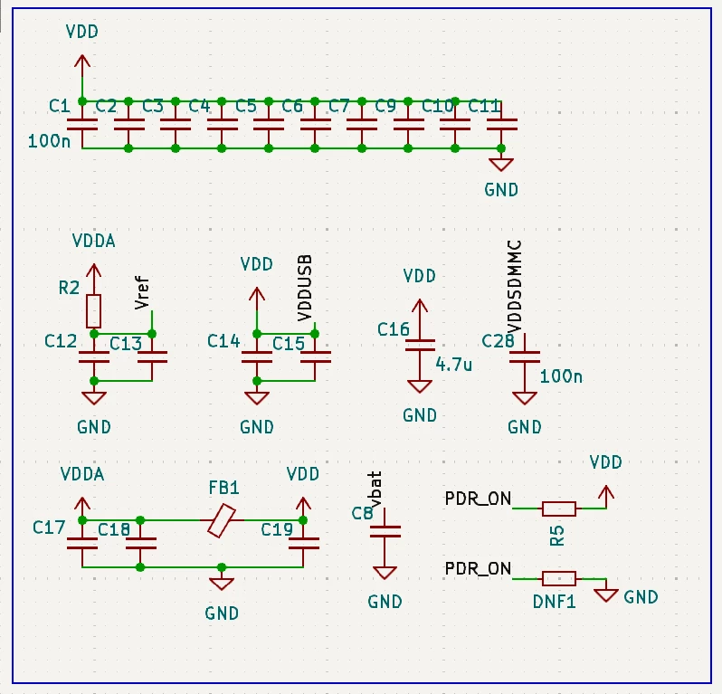

Oct 15, 2024 6:32 PM UTC
You need provide 1.8 v or 3.3v to vddsdmmc pin 132?
Richard Li
Senior
Oct 15, 2024 6:33 PM UTC
Pin 121
Oct 15, 2024 6:56 PM UTC
https://www.st.com/en/microcontrollers-microprocessors/stm32f767zi.html
@Richard Li
According to datasheet section 3.17, as per my understanding that needs to be done only when SDMMC i being used, but I will try connecting to 3.3V and then try it as all the mentioned pins which are not working have SDMMC as Alternate functions available.
Thank you for you suggestion.
@all please help me if my understanding is incorrect.
Oct 15, 2024 7:09 PM UTC
Sure, I will try this out in the office in another 10 hours and see what the result. Most likely this should be it.
Thank you for pointing this out.

Chris21
Oct 15, 2024 7:35 PM UTC

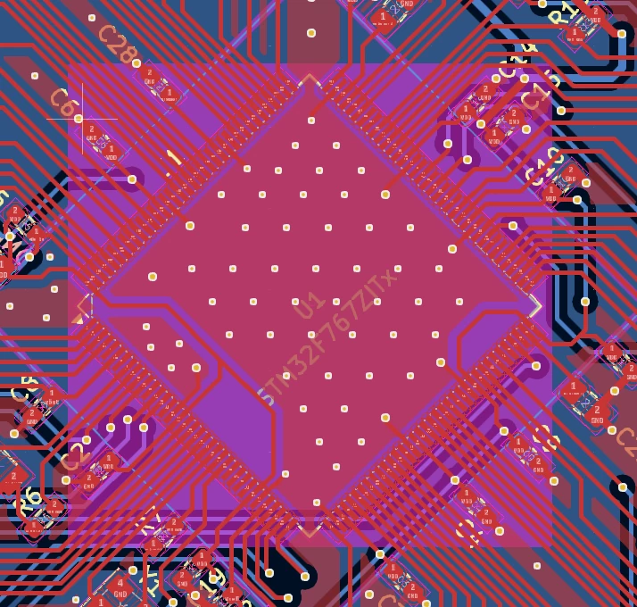

Another interesting observation.  Schematic only shows one VSS pin connected, ther should be 10.
Oct 16, 2024 7:36 AM UTC
After the VDDSDMMC being connected, all pins work as intended. This was the error
VSS is internally connected as I verified in the Layout as well as the Hardware.
Thank you for your help @Chris21 @Andrew Neil @LCE @Richard Li

LCE
Principal III
Oct 16, 2024 3:29 PM UTC
> Not sure what you mean by: "VSS is internally connected".
The PCB layout screenshot shows that the GND pins are connected to GND underneath the package.
And some CAD apps' schematic symbols do not show all VCC or GND pins. I hate that, and rather draw my own...
