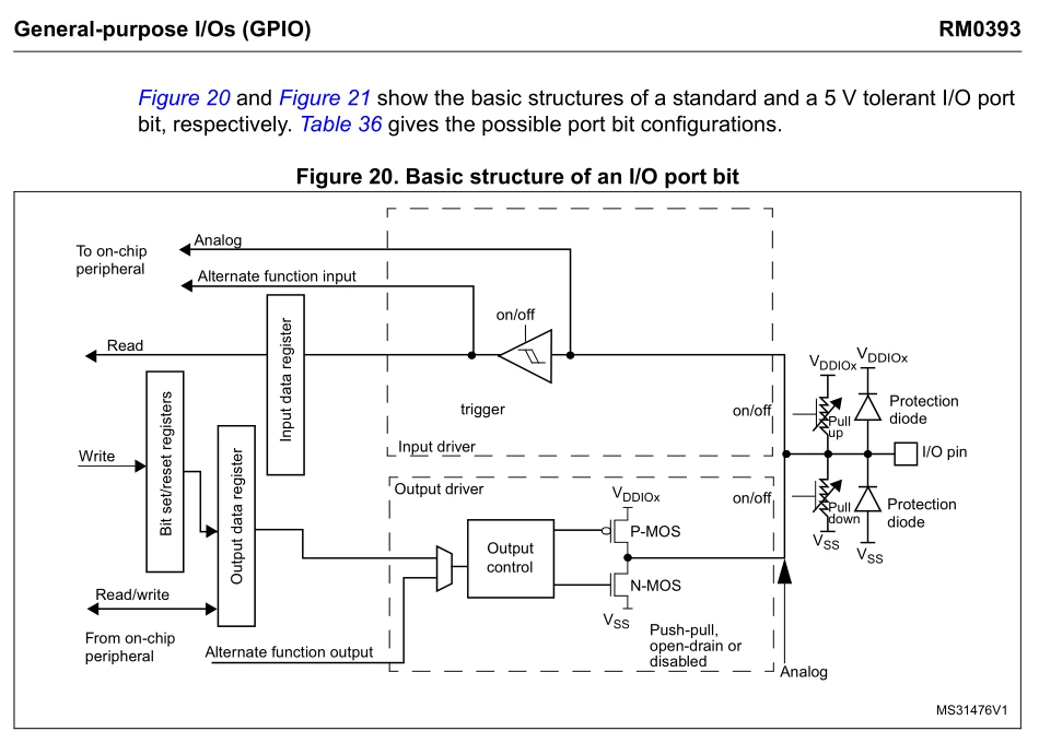

Hello there,
According to the datasheet, the GPIO ports circuit diagram looks like this in STM323L4x2:
From this diagram I understand that at powerdown (VCC = VSS = 0 V) the I/O pin state is high impedance. But is that 100% correct? I want to make sure before I make a design move that would save me some components. But for this I need to know either there are no internal pull-downs on a pin when the MCU is powered down.
I would appreciate all help.

Posted on February 04, 2018 at 07:39
My 2 cents: When the supply voltage is equal to its ground, you typically get in most electronic programmable components the ESD protection back to back diods or equivalent. If you want to confirm this, take any board, short VDD to GND and run a diod check with a multimeter.
For I2C dedicated pins or oscillator pins, the protection may be different behaviour which you can too check easily through spec and confirm with diod check (which is also sometime used to test soldering pin is ok).

Hi Lukasz,
State of GPIOs for STM32L4 MCUs:
  • under reset- high impedance
  • just after start up (when the Power On Reset is released) - analog input
  • in application - according to user configuration
Exceptions could be special functions pins: NRST pin , BOOT0 pin , Debug (JTAG, SWD) pins, oscillator pins. For example at least one of JTAG lines (PA15, which acts as JTDI) has a pull-up in reset state in order to activate debug session under reset.

Hello Szymon,
Thank you for answer. I understand reset state is equal to powered down state.

Posted on February 04, 2018 at 10:21
You're welcome. Yes, I confirm:
reset state = power down state.
