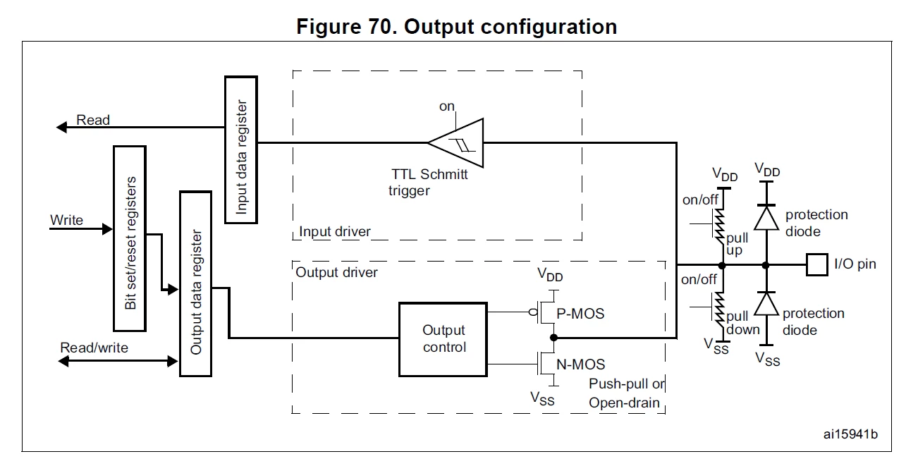

I'm using a custom board based on a STM32H735 with various GPIO inputs and outputs. The STM32 is packaged as a 0.5mil pitch BGA and the board assembly has been outsourced.
I'm able to flash a program on the MCU and debug it by adding breakpoints and visualizing registers values. However, none of the GPIO is working: I cannot drive a LED nor read a button input state. The registers are set as expected when using the HAL to set/reset a GPIO output. I've tried to bypass the HAL and write directly on the registers MODER and ODR, and the IDR register value change as expected. On top of that, I have no trouble driving a GPIO output on my STM32H735 demo board, so I don't think the issue come from the software.
I have 6 LEDs on different GPIO ports, and I cannot drive a single one of them. I also have three boards, I'm able to flash and debug all of them, but not a single GPIO.
It looks as if the GPIOs of the MCU where somehow not connected to the LEDs and buttons of my board. It could be explained if the 0.5mil BGA has been badly soldered, but I can communicate with my 3 boards through the JTAG, and not a single one of the GPIO I tested on my boards are working. This seems thus improbable to me that the issue come from some soldering/reflowing issue, as the JTAG is never impacted.
Do you have any idea on where the issue could come from, or any insight on where I should look at?
Thanks for your help.
T.

The GPIO clock has indeed been enabled.
August 23, 2023
Oh, if IDR/ODR are behaving as expected, the output pin on the STM32 is seeing the correct state. So no code bug, no need to look further into that.
Are the LEDs soldered backwards? Turn the chip off and do a diode test with a multimeter across them with correct polarity. Do they light up?
August 23, 2023
Thanks for confirming that.
Concerning the LEDs, I managed to turn them on manually, so they are working. By measuring with a multimeter on the copper track between the MPU GPIO and the LED, nothing seems to be outputed. I can't measure directly on the MPU obviously as it is a BGA, but it seems to confirm that the LEDs are not linked properly to the GPIO outputs of the STM32.
According to your responses the issue indeed seems to come from the BGA reflowing process, even though it appeared improbable that the JTAG and power of the MCU are well soldered but none of the GPIO. We confirmed that the issue does not come from software, so except if you have any other insight on what to investigate, I guess that I have to get another batch of boards, maybe from a different subcontractor.
I appreciate your help.

August 23, 2023
BGA soldering is a frequent cause of issues. Board assemblers can x-ray it to verify the BGA is soldered correctly. Good ones will do this automatically, but of course they will cost more than the cheap ones.
No other insights here. Odd that ALL of the LED pins are not working though.
Can't see a scenario where IDR mirrors ODR correctly and yet the pin isn't actually being toggled. Input and output functionality is connected at the pin itself.
Good luck.

August 24, 2023
Appreciate your help @TDK, @Tesla DeLorean.
The boards haven't been x-rayed during production, we're looking for a supplier who could x-ray them soon enough.
In the meantime we did some hardware-related tests:
We initially based our board's design on the MB1520-H735I-C02 devkit. However, when it come to the power supplies of the MCU, we chose not to use the internal DCDC (SMPS) and supply the internal LDO by a 3.3V coming from an external LDO instead. This hardware gives us the faulty results described higher.
Trying to solve those issues, we changed the way the STM32H735 was powered on the devkit to make it like our own design. According to the schematic of the devkit, this is called "LDO mode". According to the STM32H735 datasheet, this is possible by decoupling VCAP. The MCU is now powered though 3.3V on both VDD and VDDLDO pins. However, this modified devkit then doesn't boot and there is no access to it when trying to flash it. ("can't connect to target").
The issue is not exactly the same as on our design we still can access the MPU, but it look like there is something wrong either with the internal LDO function or in the way we want to use it.
Would you have any insights on that?

Laurent BEYLYBest answer
September 12, 2023
You have only connected the LDO but in your code you have enabled the SMPS.
Try to use :  HAL_PWREx_ConfigSupply(PWR_LDO_SUPPLY); in system_clock config instead of your current setting :
HAL_PWREx_ConfigSupply(PWR_DIRECT_SMPS_SUPPLY);
This should help.
September 12, 2023
Thanks for your help Laurent, you solved the issue!
Indeed, I had searched for power-related settings in the PWR tab of CubeMX, and this SupplySource setting was located in the RCC tab, I wasn't looking at the right place.
I am now able to write and read on all my GPIOs successfully.
