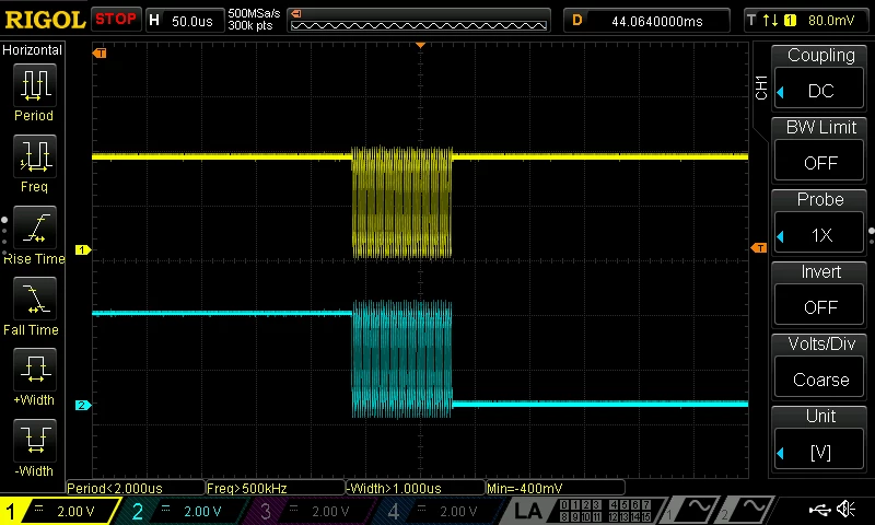

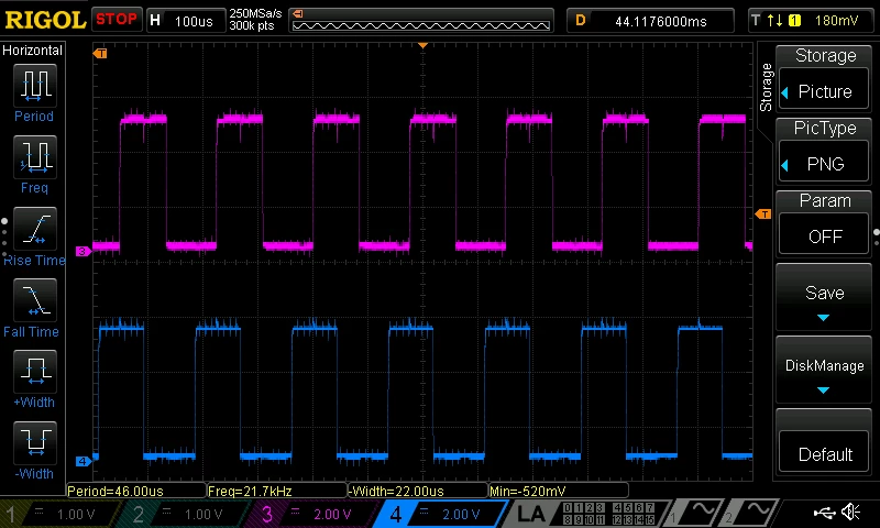

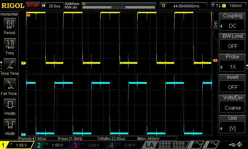

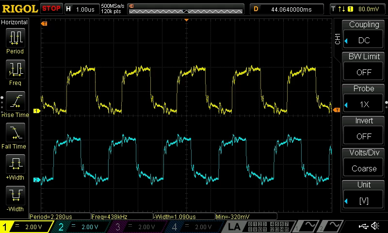

Reading from the scale (5v):
Output with HCLK at 4Mhz. DRO reads this fine:
Output with HCLK at 84Mhz. This is much cleaner than what I previously could get however the DRO still cannot read this:
My working theory is that the frequency of the last output is too high for the DRO to read. How can I rate limit this output to ~20Khz or so without setting HCLK to a lower value? Or is setting HCLK to a very low value an accepted solution?
TDKBest answer
March 11, 2026
The DRO should have a maximum "velocity" it supports. Likely it's not set up for an edge ever microsecond.
Put a small delay in the main loop after the signal is changed. Use a timer at max frequency and ensure the delay is at least X us long. That will ensure the edges are stable for at least X us.
LANLocked
LANLockedAuthor
March 11, 2026
Thank you! This seems like the correct solution.

I should also mention that despite moving the scale at a steady rate, the output seems to be grouped in small blasts of signal.

To me this looks like problematic power supply/PCB layout/ground arrangement.
What hardware is this, your own, or a "known good" board such as Nucleo?
LANLocked
LANLockedAuthor
March 11, 2026
This is a NUCLEO-F401RE
Full disclosure: everything is connected via breadboard and could be suspect.
