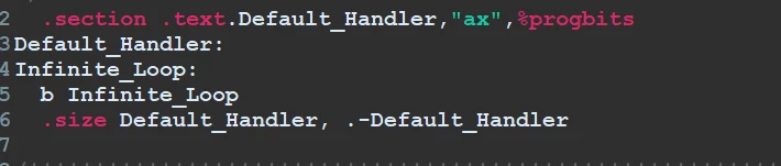

Greetings,
I am trying to blink LED using baremetal programming. I am just starting bare metal programming. My LED on Nucleo - F070 board is not being turned ON.
I checked register values on data sheet and user manual and it seems to be correct. RCC and GPIOA are in different bus and I was confused a bit. I have mentioned the code below.
Kindly, help me getting through this. Thank you so much in advance.

After inserting break point I found that program is not getting to the second line and there is some issue in below mentioned line.
RCC_AHBEN_REG |= GPIOA_EN;

Use the OR EQUAL not NOT EQUAL, ie  |= not  !=
jsoda.1
jsoda.1Author
June 16, 2024
I AM REALLY SORRY for this dumb question.
After correcting this, my program is being stuck at this infinite loop par.
