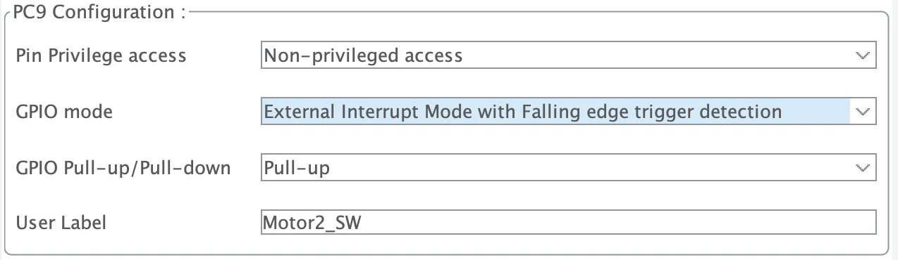

I am using micro switches in my system with the GPIO EXTI. I would like to detect only the press of the switch, but the interrupt was triggered on both press and release of the switch. The interrupts were even triggered twice on each press and release.
Here is my configuration of the pin. PC9 on the STM32H563ZI board is used. The GPIO pin is set as below, and the EXTI LINE9 Interrupt is checked in the NVIC setting.
And here is the code:
void HAL_GPIO_EXTI_Falling_Callback(uint16_t GPIO_Pin)
printf("%d\n", GPIO_Pin);
Does any one know what's happening and how to fix it?

You probably have the same problem with bouncing as described there, except that your switch goes to GND and the one there goes to VDD. You should think about debouncing, for which there are (almost) as many solutions as there are developers.
Hope that helps?

Thanks for reply. I guess bouncing might be the reason why the press is detected twice. How about detecting both on pressing and releasing? Could this came from bouncing, too?
April 26, 2024
Yes, bouncing can activate any edge trigger on both, press and release of a button. Try to solve this issue first. The most common way to do it is by adding a small capacitor between GPIO line and ground or by adding a time delay after the first edge detection.
If the button press logic is still reversed after solving the bouncing issue, you can simply change the falling edge detection to rising edge. This inverted logic issue might be because of how your button outputs a signal. There is a chance that it's connected to ground when released, and to +3.3V, when pressed.

You can do software debounce of switches. See this video https://www.youtube.com/watch?v=o0qhmXR5LD0
