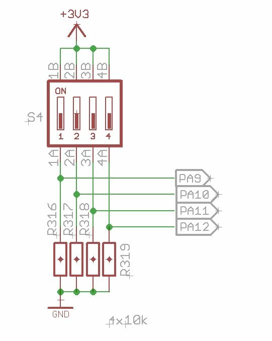

I have an odd problem with a STM32H563VGT6.
I have configured several GPIO as inputs with no pull-up/ no pull-down. The pins are wired to an external 10k pull-down and a DIP-Switch which is directly connected to +3V3. (screenshot below).
When all switches are off, I read and measure +0V on my pins. If I set one switch to active so it connects +3V3 to the MCU-Pin this pin reads a high and I can measure +3V3 with an osciloscope. The weird thing is now that I can also measure something between +1.7V and 2.9V on the other lanes, even though thex should be low and pulled down by the 10k resitor. I tried to work with the internal pull down of the mcu with the same results. I tried to configure 3 of the pins to output and set them to low. The remaining pin was set as input. After I switched the respective switch to high I got the same result and even the pins which should drive the lanes active low got some voltage somewhere between 1.7V and 2.3V.
I work on a custom board but all other functions like DAC, ADC, USART work fine and I have never had the situation that GPIO was an issue. I have already checked the bare PCB without parts for possible wrong connections between GND and 3V3 or any wrong or missing connections in the area of the DIP-switch. Seems alright and values and open lines are what I would expect.

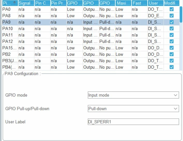

 GPIO_InitStruct.Pin = DI_SPERR1_Pin|DI_SPERR2_Pin|DI_SPERR3_Pin|DI_SPERR4_Pin;
 GPIO_InitStruct.Mode = LL_GPIO_MODE_INPUT;
 GPIO_InitStruct.Pull = LL_GPIO_PULL_DOWN;
 LL_GPIO_Init(GPIOA, &GPIO_InitStruct);

mƎALLEm
January 22, 2025
Sorry but here you are configuring the internal pull down:
Could you please double check?

gbm
January 22, 2025
Looks like there is no ground connection to the pull-down resistors. The resistors are not really needed, as the internal port pull-down is enough.

@gbmThe external pull-down resistors to ground are properly connected and they are the 10k. I double checked with a multimeter on two different PCB. And the whole ground and supply voltage network of the PCB seems ok as well. I checked with an oscilloscope. The levels of 3V3 and +15V look stable and the osci did not trigger any change of edge. I also measured GND to GND on several different places. It was all in the range of a few mV. Nothing out of the ordinary.To rule out the DIP switch we soldered it out and hard soldered a bridge to one of the paths, same problem.
Just as I am writing this there is one idea comming in my mind that we have not yet tryed: I am going to solder out the 10k resistors and the dip-switch so there really is only the one path with high and the other pins are let open with internal pull down. If I still can measure weird behavior it has to come from some internal connection between the pins on the port. If the beavior is right then there is a mayor problem on the schematics or the PCB.

gbm
January 22, 2025
Remove the resistors, keep the switch. For me it looks like 99% that some ground connection is missing, either for the resistors or one of MCU's GND pins.

LCE
Principal III
January 22, 2025
What's the MCU's actual supply voltage?
I would never connect any supply voltage to a GPIO directly, I'd put at least serial 100R in there somewhere.
And I support gbm's idea about the missing / bad GND connection.
We once had a PCB where someone gave the wrong net names to all internal GND planes, that was a mess...
PS: If somehow that GPIO bank A is not running from 3.3V but any lower voltage, then your results might make some more sense
