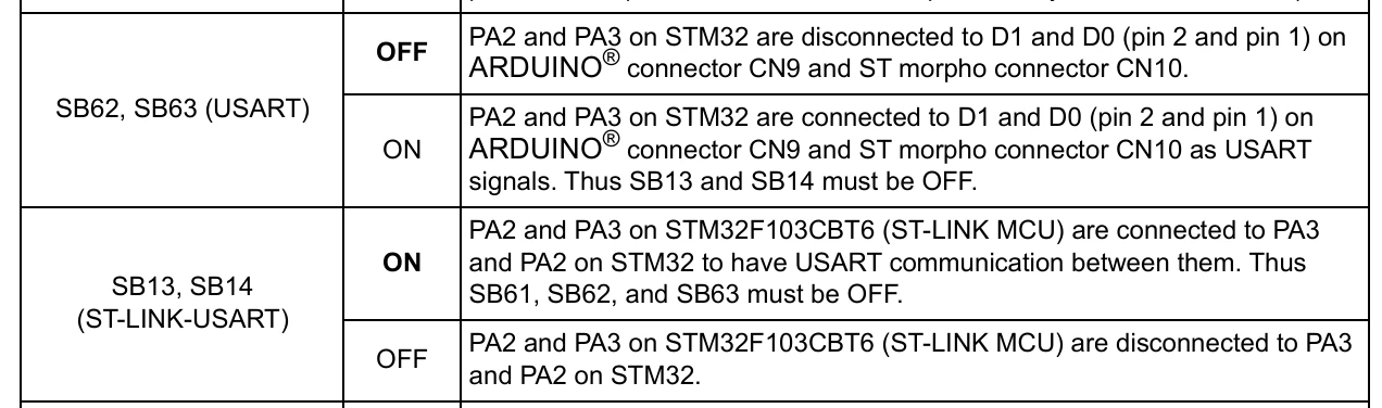

Issue unable to configure pin pa 2 and pa3 as output.

.EVEN I USED DEBUG MODE TO CH CK WHETHER BITS ARE GETTING CONFIGURED OR not.everythings I working fine expect pin is not going high.
When I use sam steps of other pins of same port PAx ,it works.
Please help me onthat one more I checked whether these pins are configured to work with uart2 even though I am configuring moder and odr .but nothing usefull I got.

Where are you measuring the pins? PA2/PA3 are not connected to the headers by default. See the user manual. You will need to modify solder bridges to change this.

PA3 is going to be driven by the on-board ST-LINK/V2-1
You can find a schematic, and review that, from the CAD Resources tab on the product page.
