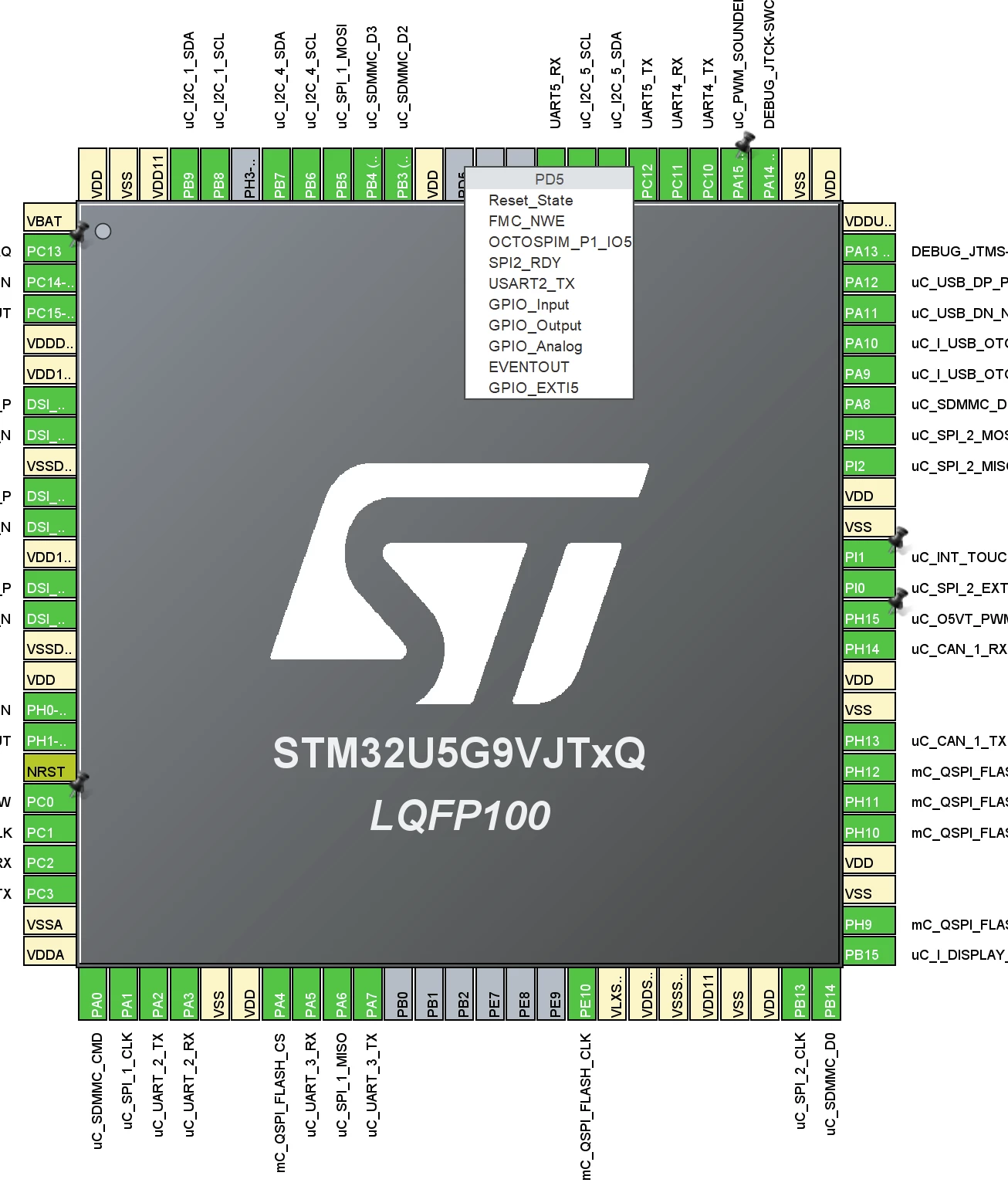

on the STM32U5G9VJT6Q, when I click on many pins such as PD5 (screenshot below) it shows GPIO_Analog but there does not seem to be any ADC channels (or other analog functionalities) connected to it.
What does setting it to GPIO_Analog do?
Can I still assign somehow a ADC to PD5? If so, how?
Thank you :)

The reason to turn ANY pin to analogue is to turn OFF the schmitt trigger on the input that feeds down stream digital logic. This will decreases a bit the current consumption of MCU. That is why Analog Input is a recommended mode for all GPIOs, which are unused by application.
For the PD5 of the STM32U5G9VJT6Q, we can't use it as ADC Channel.
