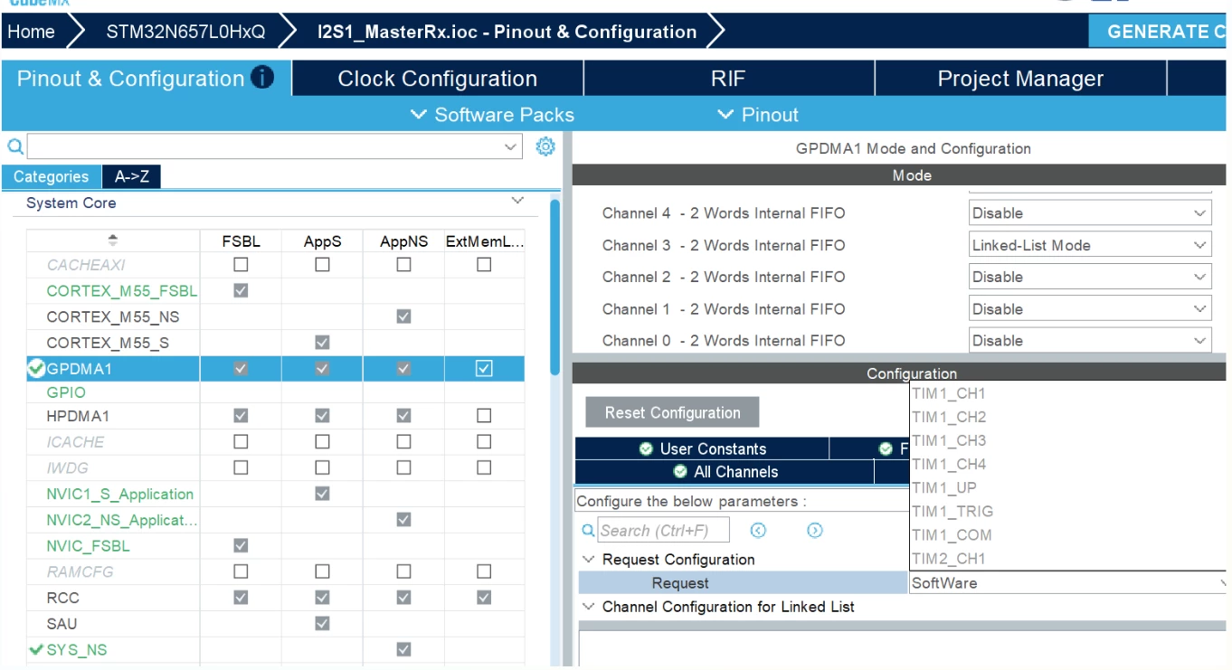

Hello ,
While configuring the I2S1 why i cant  find its reference on the GPDMA1? Is it not available for DMA transfers?
All other peripherals are available ( like uart,SPI,I2C but not I2S).
Here is the snapshot.
Regards,
D

AScha.3
August 14, 2026

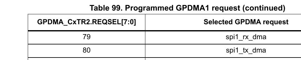

for audio ?  Why not using SAI , in I2S mode ? Its in the dma to select.
I2S is other function of SPI , so check the SPI you use in I2C mode .
